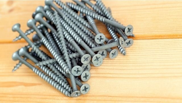

Screws also have several grades of quality. Cheaper ones are often made of softer metals like aluminum or lower grade steel that are prone to corrosion and rusting. For higher quality screw look for Hardened Steel, Stainless Steel or Titanium screws in ascending order of quality and price.

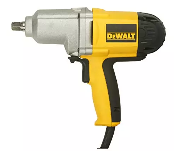

Avoid 1/4 and buy 1/2 inch corded impact gun from dewalt.

Getting my screws from a wholesale screws and bolts shop recommended by almost all the woodworkers i’ve asked, although i’m using lag screws like pic attached and i’m currently working with mango wood which is tough to drive screws in even when i pre drill all my holes
Mango is soft wood and should have been easy.
Whats the exact issue you facing ?
Are you not getting enough torque from the driver
or is the bit slipping from the screwhead (and in process stripping the head)
or is the screw itself getting stripped without any slippage from the bit
PS: For screws this size and softwood like mango, do not use impact mode and instead use normal screwdriver mode
mango from my limited experience feels like a hardwood ngl driving screws into it requires a lot of force . Whether i pre drill or not when i join two pieces together the screws seem to go in about 2.5-3 inches and then the bit begins to slip from the screw leading to the head being stripped and after i did some test runs joining 2 cut pieces together with different methods i settled on using the drill mode. Also sometimes when i successfully drive a screw all the way in it breaks right where the threads start even though i drill a countersink hole for the screw the drill i use is this one btw
