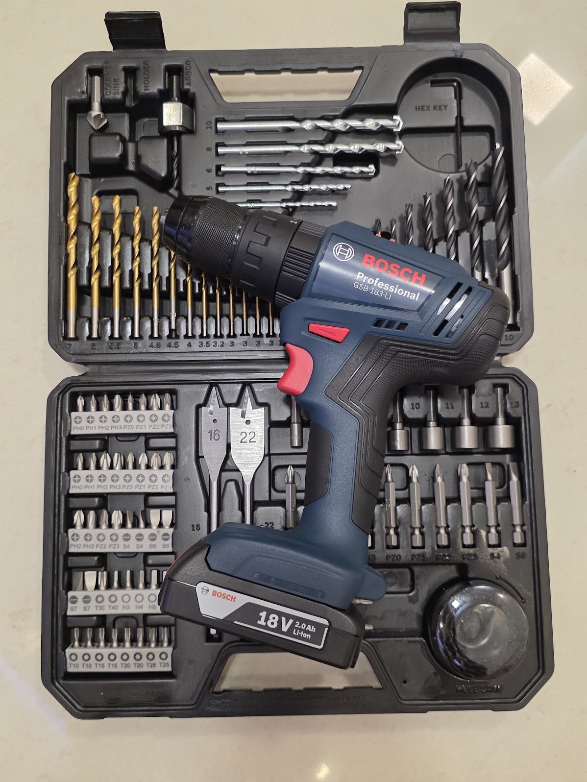

edit: @6499 bosh gsb 183 looks like a good deal : [gsb 183](’
Amazon.in
Thanks, folks. Treated me with the same.
It’s ridiculous. Everything is so easy now. Sawed a big hole into the wood, put a screw in the metal for the first time. Too easy. Ordered a few bits for tiles. Ceramics will become holy tomorrow.

Congratulations. Looks awesome. Don’t forget to set a low torque value before screwing in stuff to avoid stripping the screwheads. You can always increase the value if it doesn’t go in.

Edit: Just saw your picture with the Bosch you purchased. Congratulations.
