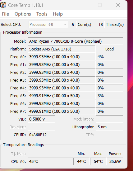

whereas my 7800X3D keeps chaning bus speeds.. frequency bouncing anywhere from 3500-4850 every second on all cores ?? ? whereas my 13700kf was always pegged to whatever frequencies i set or was stock.. on reddit i can see people even hit 5ghz on 7800x3d.. but i’ve never seen that?
my 7800x3d idles at 50-60 and around 70-75ish in games with a 360mm which i also find very odd? not sure what is going on here.. any help is appreciated.

Frequency fluctuating is the norm and thats how these processors are designed to function. My 5600x fluctuates every micro sec. in core temp. I tried it both- power options min/max processor state set to 100% as well as 5 & 100%.

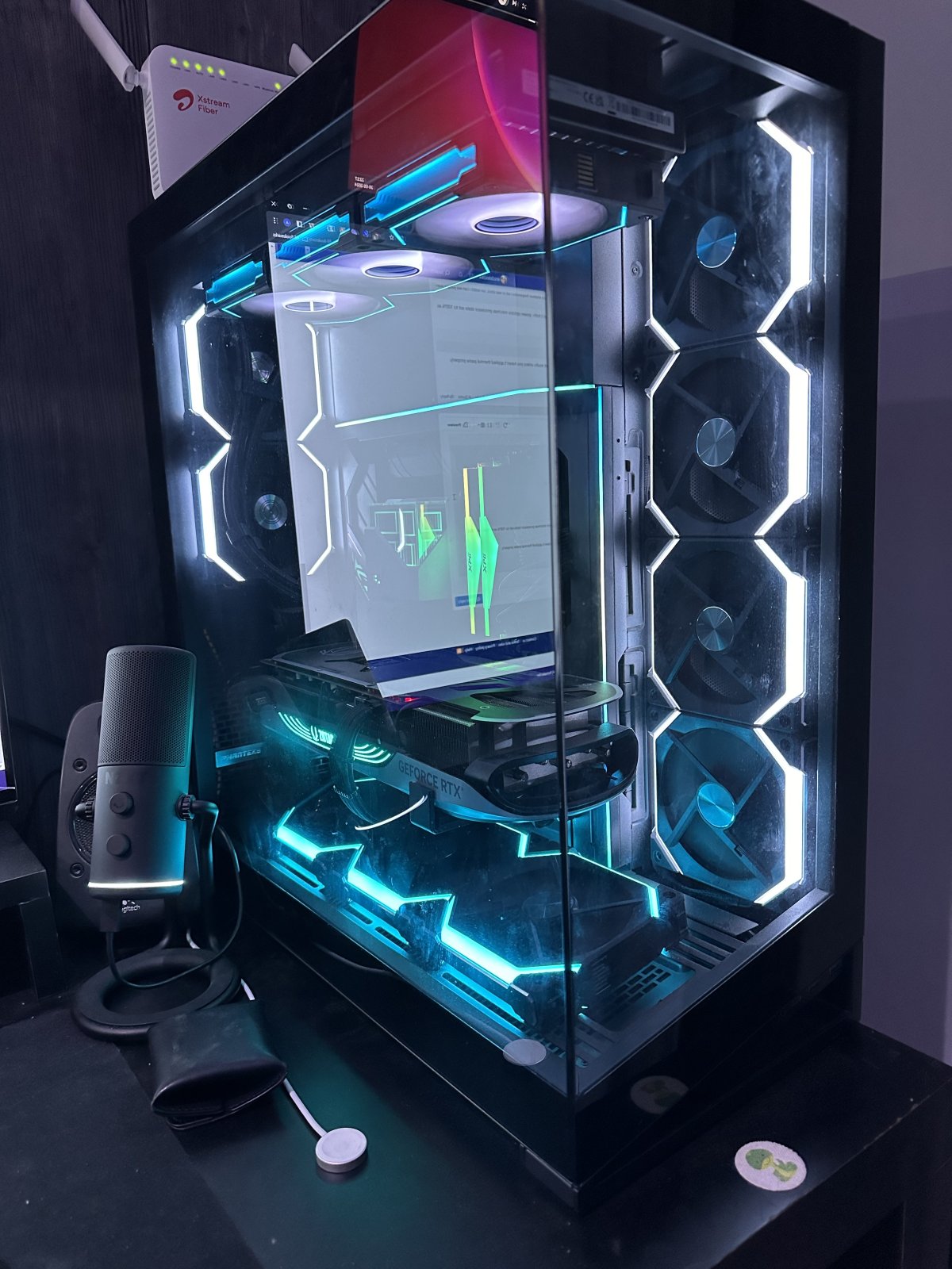

this is literally how my system looks.. if these many fans and a 360mm aio in winters cannot keep it below 60 C at idle.. idk what will?
I spent a good 1 hour today.. repasted.. cleaned the radiator and put fans in pull also.. so now its a push pull.. its idling around 45 C now.. so that is atleast a good sign.. 45 C idle is way better i must say.

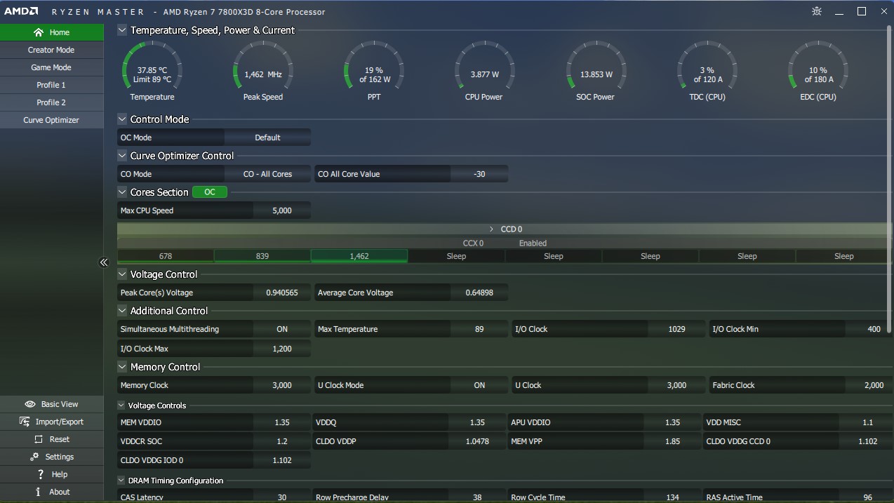

I have a 7800X3D, and this is what I keep my settings to:
  1. Enable a negative CO as far as your cores allow you. I have mine set to -30 on all cores, which helps the CPU run cooler and boost a bit higher
  2. My SoC voltage is manually set to 1.2. System is stable.
  3. Keep MCR enabled, avoids memory retraining where possible, and system boots faster. I get no BSODs.
  4. I use the stock EXPO profile. Mine is also a 32 GB 6000Mhz CL30 kit.
  5. iGPU is enabled.
My idle temps are much lower, at around 37-39C. This is with a D15s.

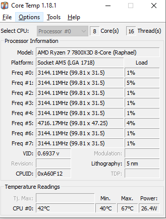

Currently, my idle temp is 42 with lowest being 40 in Mumbai.
Also - core temp and others i think can give slightly wrong temp numbers for some reason. Ryzen master should be correct.

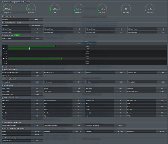

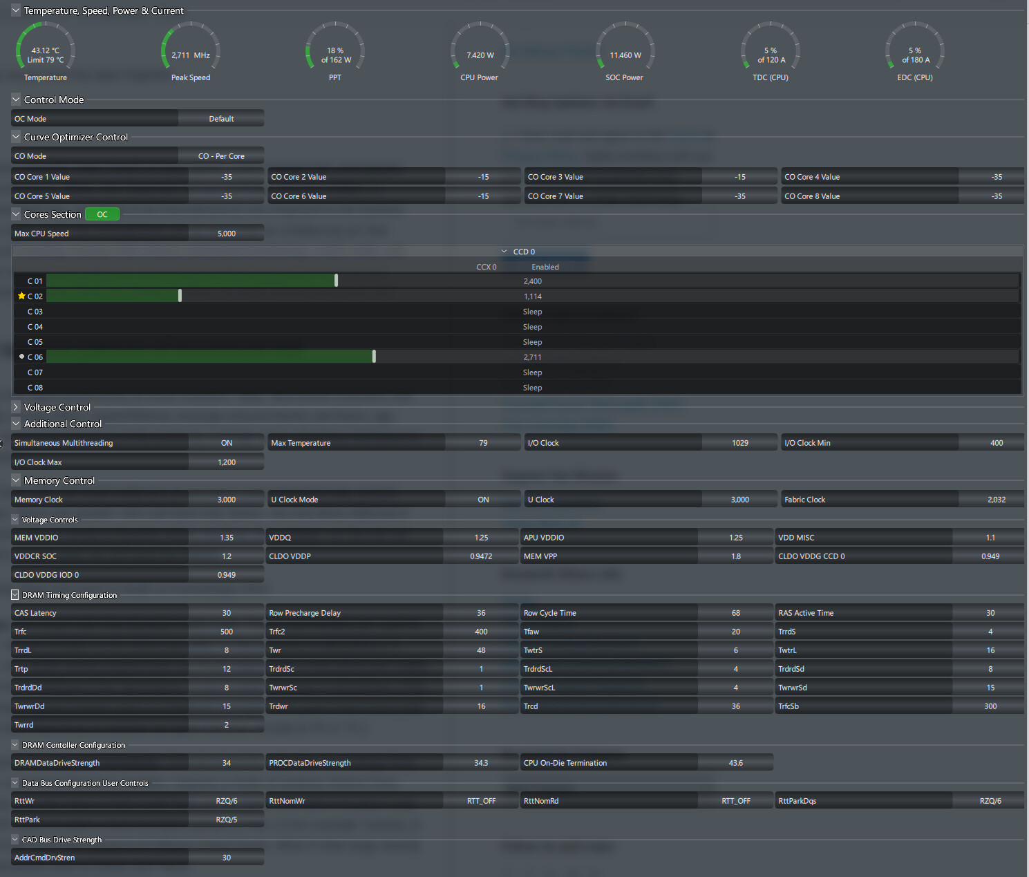

Mine does not do -30 all core either. It works usually, need a good stress test to make it fail. prime 95 works well ( with small data i think so that we test the cores rather than the memory)
Generally best 2 cores( marked as star/circle in Ryzen Master) cannot be undervolted as much, probably because they are already factory tuned.
I had to manually tune it per core and get something that was stable enough and then i reduced everything by 5 just to be safe. So far that has worked well.
This only gives small bump in performance, like 1.2% or so. Temps i don’t think changed much not sure.
But anyway, i used CO and then set max temp limit to 79C from 89C and i still get a 0.6-0.8% bump in performance.
Max temp can hit easily in all core workloads, it does in my work atleast.
My gaming temps are in mid/high 60s usually i think but they do spike to 70s.
I also tuned memory from a bulldzoid Hynix RAM guide + 6000C30 32gb @ 1.35V for ram and 1.2V for soc.
