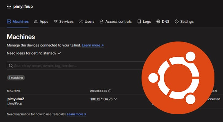

Get started with syncthing, its very simple, just set it up on your phone, laptop,etc and install it via docker on your server. To access your files, you can just use samba, very basic though. If your ISP support port forwarding, its gonna be a breeze, just setup ddns, forward the ports in your router admin and you’re good to go. If not, you can get tailscale vpn.

If you really wanna learn, watch some videos and research a bit about the keywords I mentioned.
If you just wanna setup things, here you go
These resources are enough to get you up and running. There are many avenues you can follow to upgrade your stack once you understand how the bits and pieces move.
These guides are specifically for Ubuntu, which in my exp is very easy to set up and running for a beginner. Feel free to ping me if you get stuck
