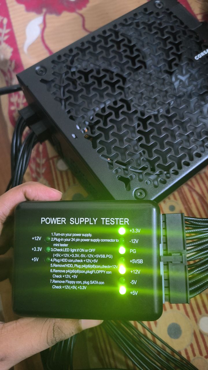

Hi, guys. I bought a Corsair RM1000x for my PC from Elitehubs to replace an old PSU. When I connected the PSU to the motherboard (24-pin, CPU, and PCIe), the PC didn’t boot up. It had no power, no onboard LEDs, and the fan wasn’t lit. I tested again after undoing the connections, but the same issue occurred. After that, I tried connecting the motherboard with my old PSU (Corsair TX650M), and it worked perfectly.

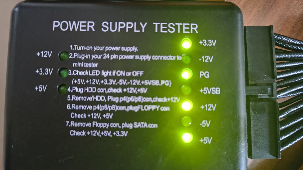

I had a PSU tester from Amazon lying around, and the 5VSB rail on the new Corsair PSU was dead—it never showed a green light on the 5VSB. I sent the PSU to Elitehubs for replacement, but now they are saying it works fine with their test rig or whatever. I’ve asked them to show voltage values for both the 5V and 5VSB rails using a multimeter to confirm what they are saying is correct.

Update , from elitehubs they are saying the psu is working without providing any proof of any readings. Now asking to me provide two way return shipping and they are saying they cannot do rma on my behalf on a new product. Totally bad service, regret buying it from here as it was 2k less than Vedant and mdcomputers. They have asked to me ship it to Mumbai instead i have gone for rma with corsiar in kolkata itself.
Absolutely bad service refused to provide 5vsb readings or any readings from the psu.I have asked them to provide a psu tester or multimeter readings. Just provide a video with psu working without case, their technical team turning on the pc by touching the power on pin with screw driver. Is the 5vsb rail is weak or not consistent got no clue.

Update: After receiving the PSU from Elitehubs yesterday, which they charged me 600 rs for return shipping, I went to Kaizen and they confirmed the PSU is faulty due to the absence of any voltage from 5VSB rail. The people at Elitehubs couldn’t even properly detect this obvious fault, despite i exactly identified the issue for them. Future buyers beware, if you receive a DOA product from Elitehubs, it’s best to go directly to service center for an RMA, otherwise, any hope of a replacement for an obvious DOA product will be denied, and you’ll be charged for return shipping. Also, if anybody from Mumbai have contact no of the owner or higher ups for the elitehubs will be be appreciated, they wasted my time and money both.

The tester looks good, can you share the link for the same. See many similar types listed on Amazon. Hard to call out which is good and which is bad.
Its this one they are all generics RTS Premium Quality PC Power Supply Tester 20/24 Pin PSU ATX SATA HDD SMPS LED Display : Amazon.in: Industrial & Scientific, but there is no need for tester, if you have multimeter lying around its easy to measure the voltage by following the atx 24 pin layout.
