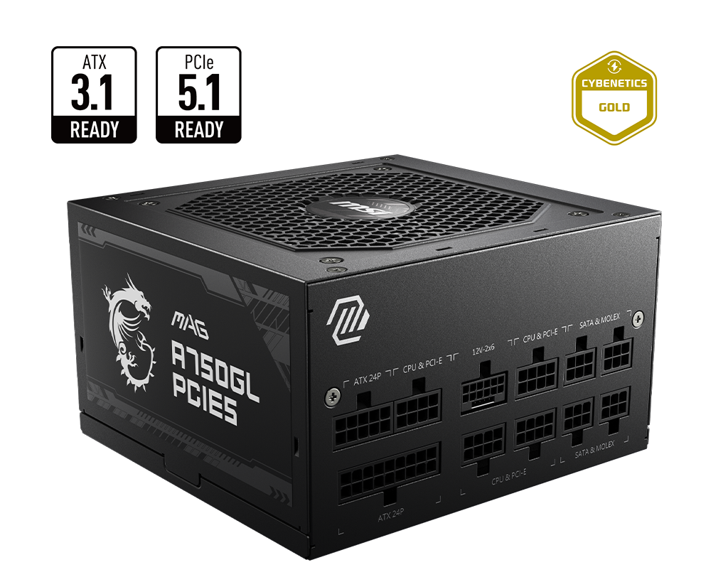

I suggest you either go with MSI MAG A750GL or MSI MAG A850GL Gold Fully Modular PSUs.
Then in Deepcool you can go with Deepcool PM750D or PM850D Gold Fully Modular PSUs.
MSI PSUs are ATX 3.0 ones while Deepcool are ATX3.1 ones. Both have support for newer RTX40xx and RTX50xx GPUs along with RDNA4 AMD newer GPUs.

750W is enough - MSI A750GL for a good one

  1. MSI MAG A750GL PCIE5 ATX 3.0 80 Plus Gold Modular

It’s better to go with MSI A750GL 750watt Gold Fully Modular ATX3.0 pcie gen5.0 compliant from here
@ ₹7.5k
