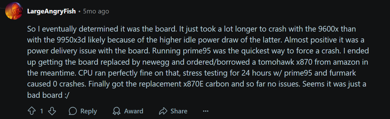

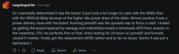

Apparently this problem is common with 9950x3d users. A lot of people are having this problem, as can be seen here, here, here and here.
