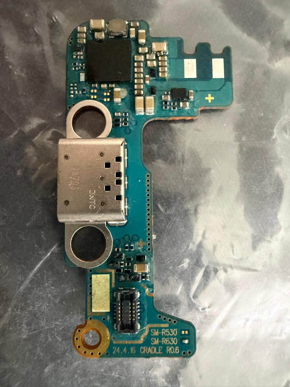

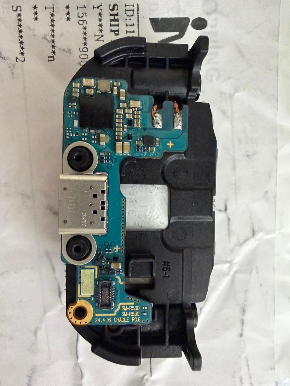

I am glad to inform that the replacement motherboard arrived today from China.
It cost me a total of 900Rs including shipping and taxes.
Soldered the wireless charging coil and it was up and working in 10 minutes.
Pictures attached for reference.

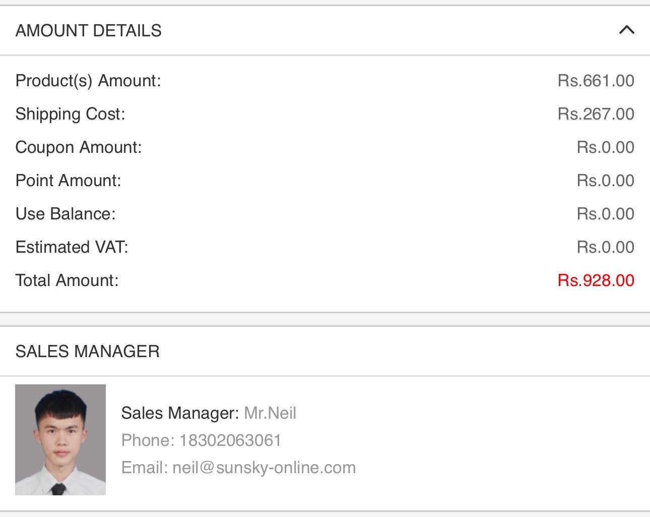

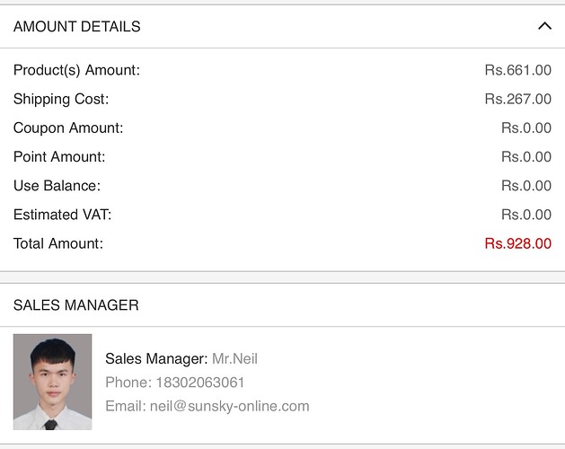

Please elaborate on this….where did u get it from? How much did it cost in shipping
Yes even I am interested, please share in detail and the links :folded_hands:
Guess he never tried the service centre and went with the direct purchase
Yes, and it’s costed cheaper as well.
Interested to know the sourcing and delivery of the part.
I selected yanwen as shipping partner, the board cost Rs.661 and shipping nearly Rs.250 including custom clearance.
I did go to the service centre but both of my buds have small cracks, they said I’d have to buy a whole new set and this was unrepairable.
Ordered it using the above mentioned link, Paid via PayPal and selected yanwen as shipping.
I had ordered early feb but due to new year over there it only got processed 10 days later, once shipped it reached me in about 13 days.
