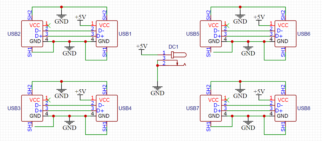

I designed this adapter which will use external power for all 4 ports and only use data communication lines for data transfer between USBs and Raspberry PI.
Here is the schematic.

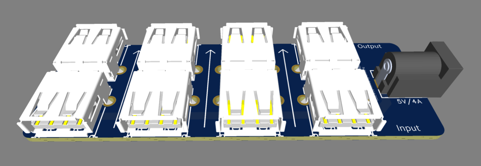

How it will look like :-
In 3D
You will have to use 20watt 5V/4A power supply for this thing, if you want to supply 1A to each USB port one I could find is this one -
Thingbits India | Raspberry Pi, Sensors, Robotics, Parts & Accessories](‘http://https://www.thingbits.in/products/5v-4a-4000ma-switching-power-supply-ul-listed’
But normally using 10watt 5V/2A will also work fine for SSDs which will split into 0.5A to each USB port. I think that’s what they require not sure.

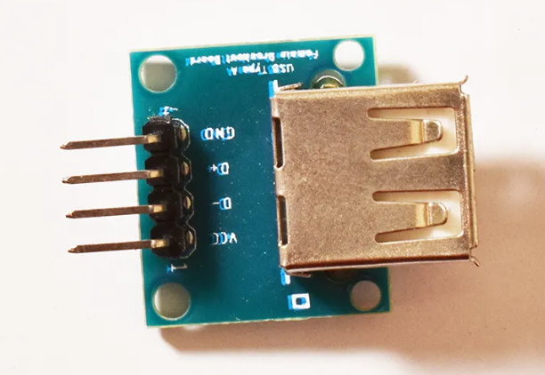

You you can rig one yourself up using these of the self modules called USB Type A Female Breakout Boards, but I don’t how reliable this will be. You will be needing 8 of these and some dupont wires for connection, a power connector and the schematic above.

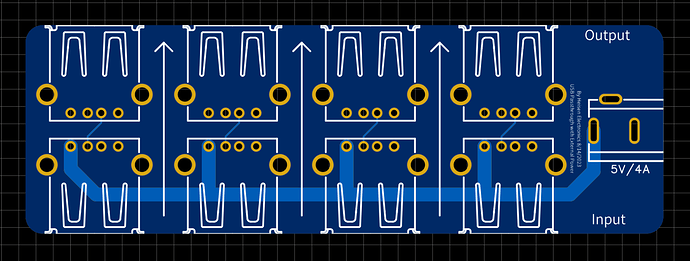

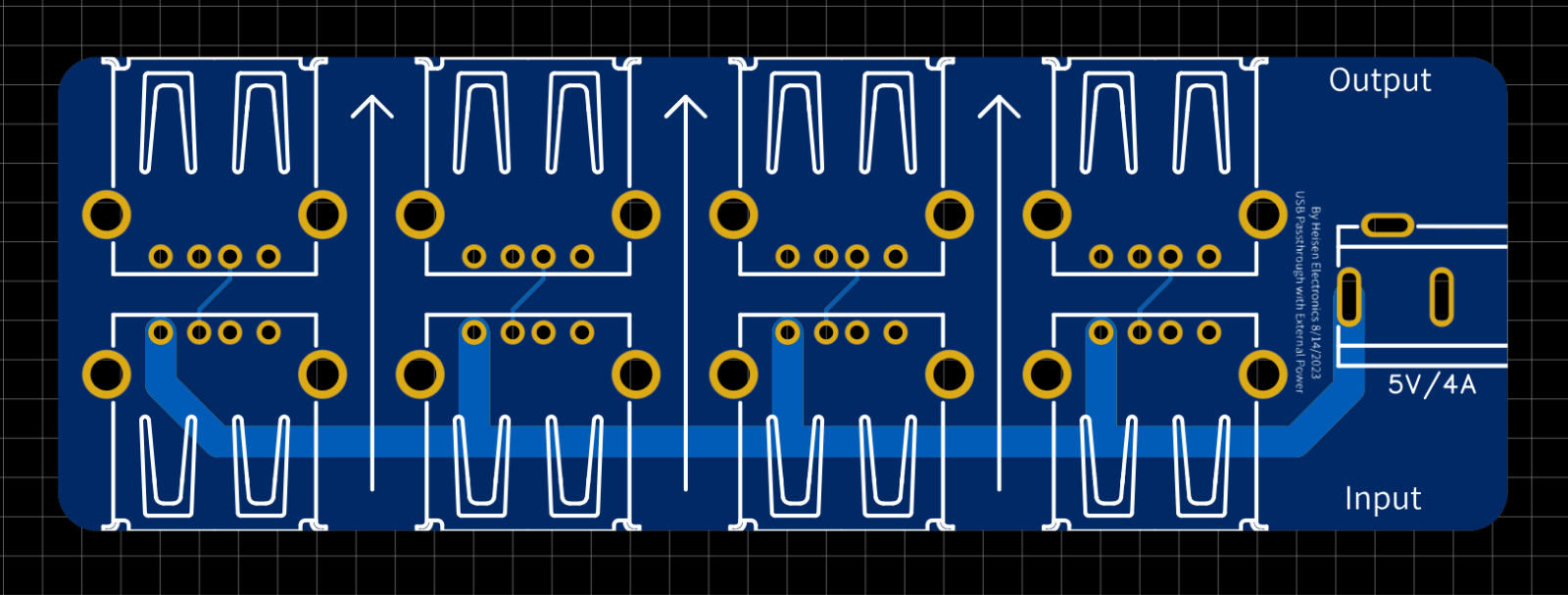

I am attaching the 4 layer PCB gerber file for manufacturing if anyone wants to develop this board. I take no responsibility of it’s working cause it’s a fast prototype, but 90% sure it will work, don’t plug the connections in opposite, something might go boom, because there is no protection circuitry involved.

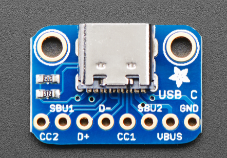

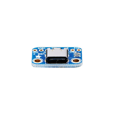

You can simply get modules like this -
VBUS is your positive supply and GND is ground. Leave all the other pins. If you like I can add this connector to above board at later time. It will hard to solder though because of very tight pin spacing as compared to DC barrel jack to the PCB.
