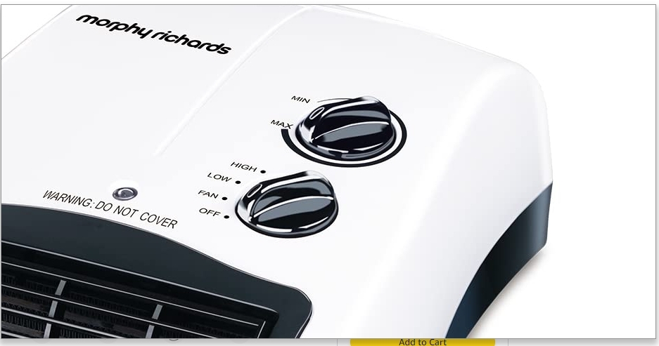

The reason I am not looking at PTC heaters are I need a fan too. I understand the fan you say is not that powerful but if it is just about decent also. It should be okay for me.
Metal heater (as suggested by @@Fenix) has a better fan than plastic ones. Offline price would be Rs. 1200. Go for it.
And PTC is having fan too, the price is 2200 offline-2600 online.
https://amzn.eu/d/6kTHI34
