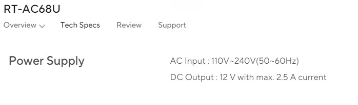

Also, the power adapter I got was 12V2A, Asus router states 19V 1.75A as requirement, have contacted @@Prosenjit and they said the original adapter was missing so they sent a compatible one.
Let’s see if I can find a 4x1.3mm barrel jack, or would just patch it like @@lockhrt999 suggested. Thanks @@t3chg33k as well.
Seems it is a standard Asus 45W/65W barrel, so you can use any of the USB C to 4.0x1.35mm adapters or cables.
https://www.amazon.in/Concept-Kart-UX31A-R4003V-UX21A-R7202F-UX31A-DH71-CA/dp/B0BDG8RD2H
Official adapter outputs to 12V only. Where does it say 19V?
19V is usually used by laptop chargers. Maybe it’ll direct fit.
The router sticker itself says 19V 1.75A.

RT-AC68U supports 12 volts onwards up to 19 Volts. If you use 12 Volts, it will draw approx 1.8A to 2.25A based on your application run on that router. If you use 19 Volts, it will draw 1.15A to 1.4A
