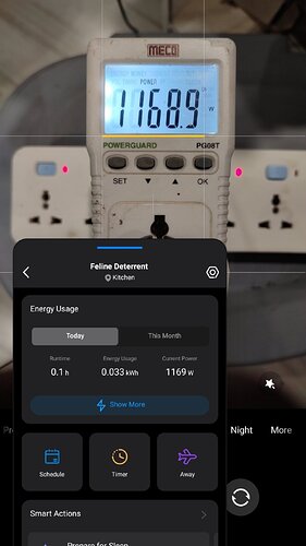

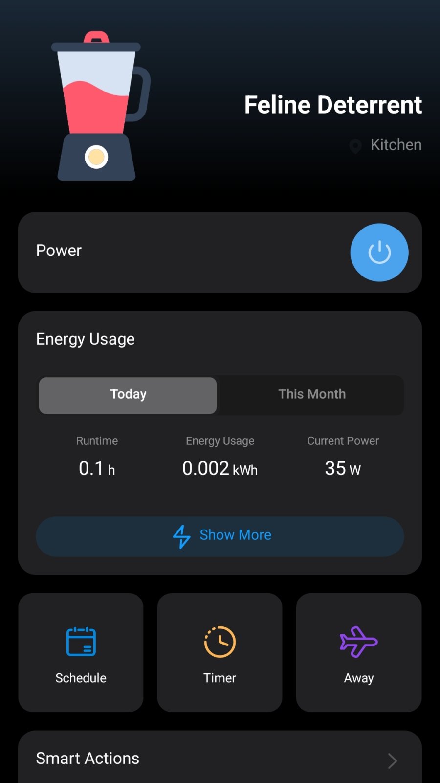

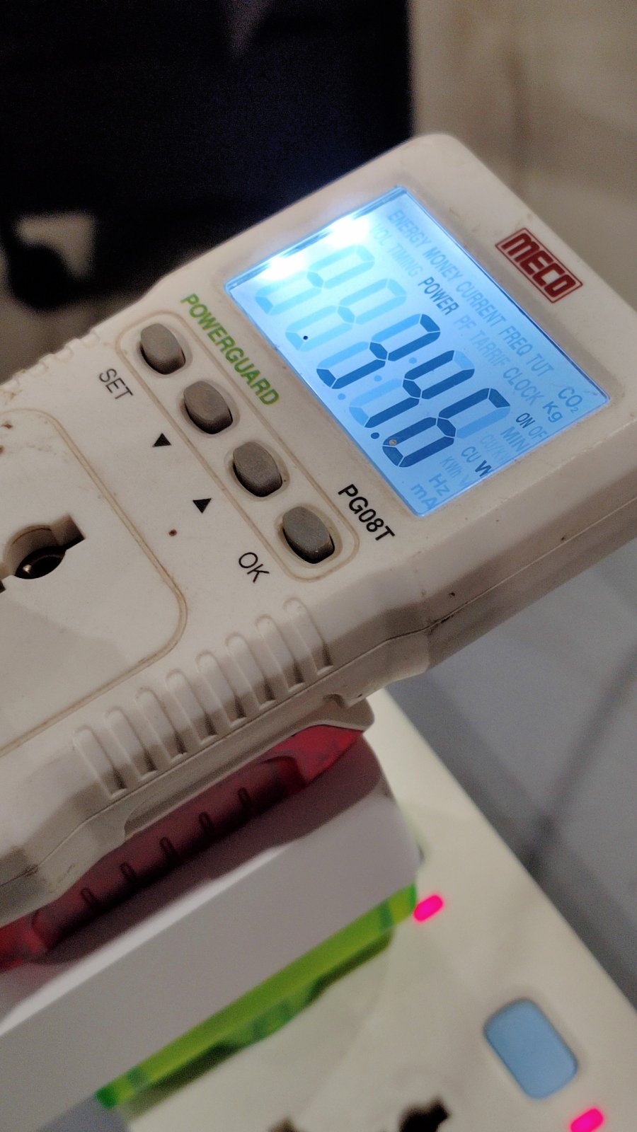

These TP-Link Tapo ones are just as accurate as the calibrated Tasmota ones.
It’s very impressive, I tested it just now at a small load and at a >1kW load:
