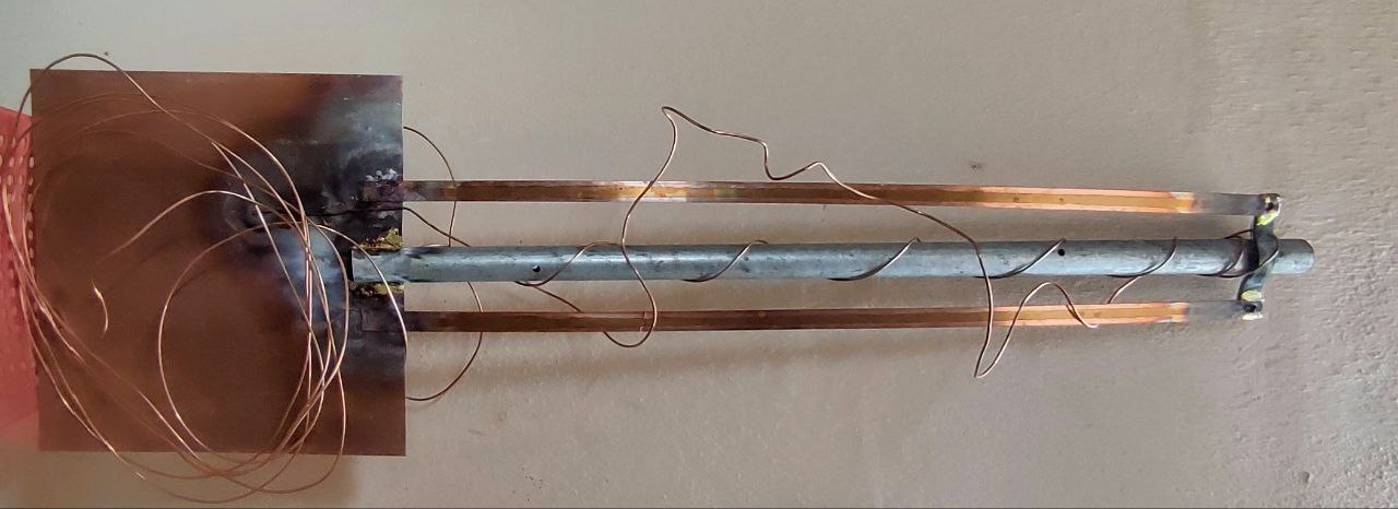

Do not hold back on the Earthing pit. Put ample coal and a large copper plate along with salt. There are several videos that guide how to create an earthing pit.
Additionally, connect this pit to an earthing rod and fix the same on the roof. This will help protect your standalone dwelling from Lightning strikes as well.

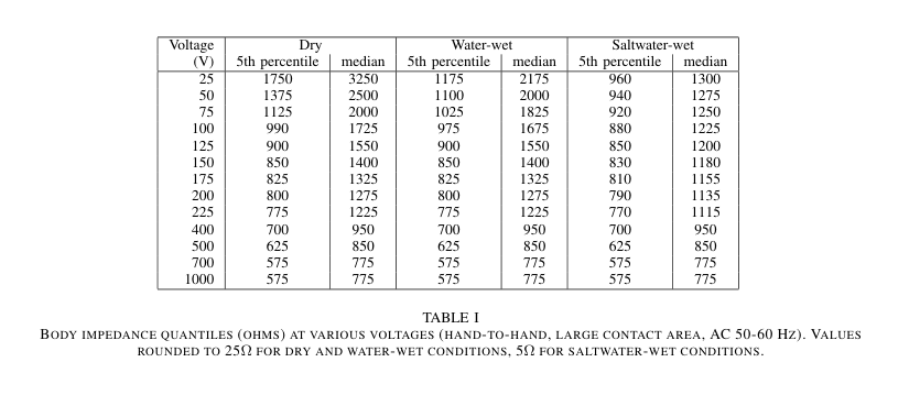

I believe up to 4 volts measured with a high impedance meter is acceptable. The actual resistance must be below around 5 ohms, specifically allowing for highrises to be able to meet spec - a building two hundred feet tall cannot meet the 1 ohm spec at all. Human body model is to the order of 750 ohms to about 2kohms. We’re in the process of actually designing a mains conditioner with isolated outputs and had to do a ton of reading on the subject :slight_smile: The allowed fault current is 30mA on the live output, which is what most domestic RCCBs are targeted at.
Taken from:
https://researchspace.auckland.ac.nz/bitstream/handle/2292/55080/electric_shock_2.pdf?sequence=1&isAllowed=y
Another link that might be useful:
