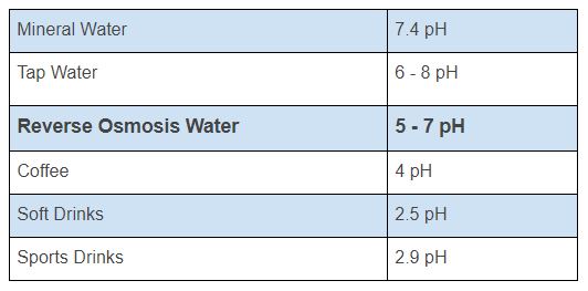

What’s your take on consuming alkaline water?
Meaning water that has a higher than usual pH coming out of the tap. So if normal water is around 7, then I’m referring to water of pH 8-9
I wonder if RO can reduce pH.
I have no opinion on this matter. Still, I think it depends what kind of minerals the water is carrying. Metal salts increase the water Ph. Our bodies need dozens of metals to survive. In the cities, the groundwater is bound to carry harmful metals. Lead is one such example. It’s omnipresent. You don’t want alkaline water with lead salts.
Our digestive system, although a state of art technology, isn’t perfect. It sometimes fail to distinguish between different metals thanks to their similar valencies (I think that’s the word).
But yeah, RO should be able to decrease the pH.
