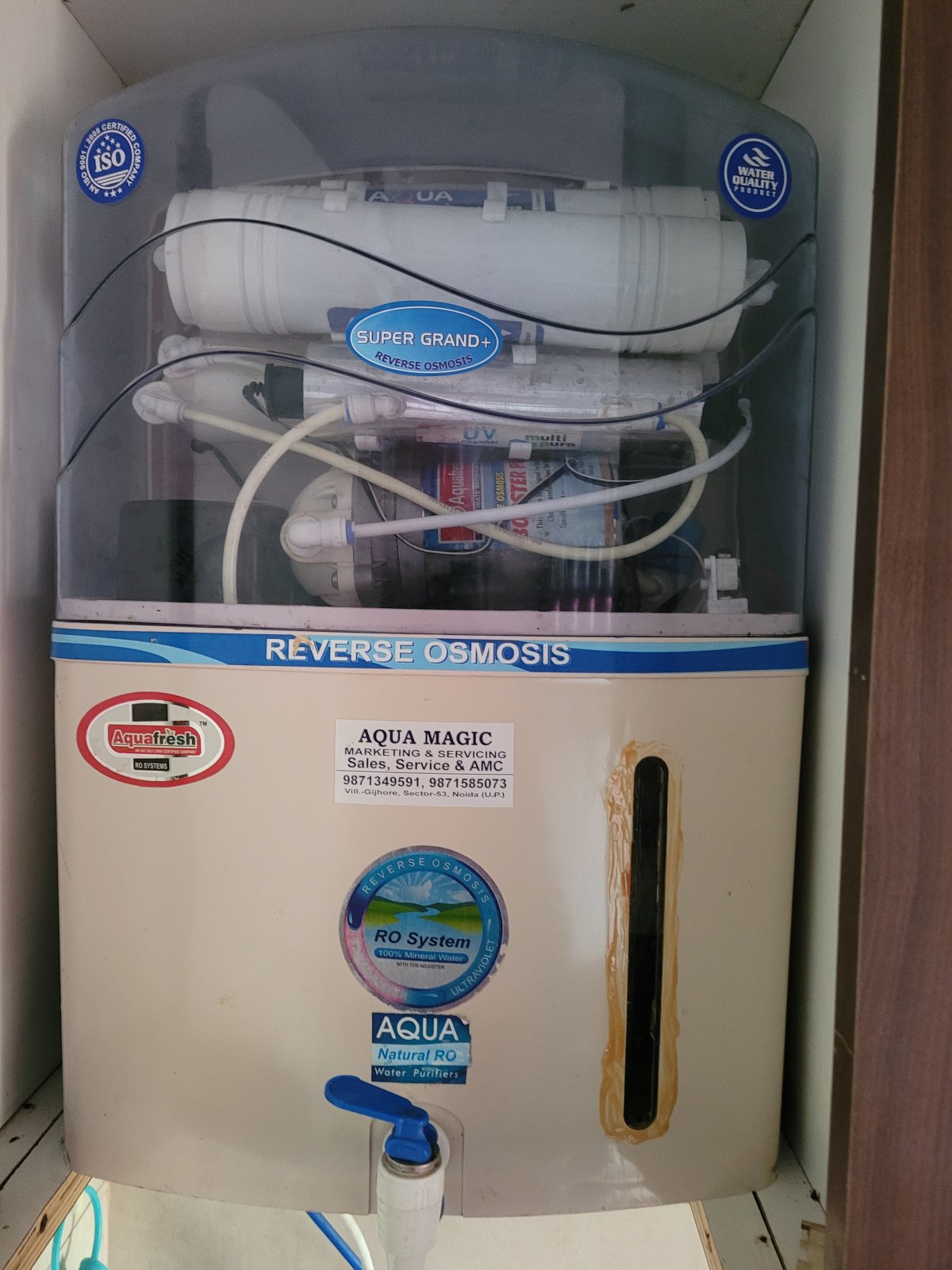

I mean image of water filter at your place, using since 2015, it seems good company, we don’t know, even the same company may manufacturing few Branded Purifiers

My water filter is not branded. Just a local make. Aqua something.
meant something like this. similar to what i use →

would like to click image of your Generic Water Purifier and post here, it’s good that still it’s spare available in market and one can replace/install it without Tech person help, technician charge 500-700 for first installation + Rs.2500/3000 as 12 months AMC

My generic RO system. Bought in 2015 for 4~4.5k. Can be maintained by ourselves as there are no complex parts. Membrane last changed 2.5yrs ago. Input TDS is 750+ and output RO water is 50~75TDS. Only issue so far, it started to leak near the water display section in the storage tank. Sealed it with epoxy resin and hardner. Thats the brown lining
