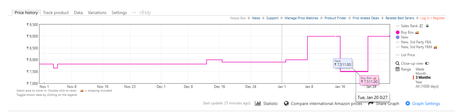

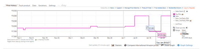

i just checked the price history, it looks like you have bought the product at its highest price :slight_smile:
better to get some pure sine wave solution. These modified sine wave ups stress out the psu.
I paid 7650 for the legend model
