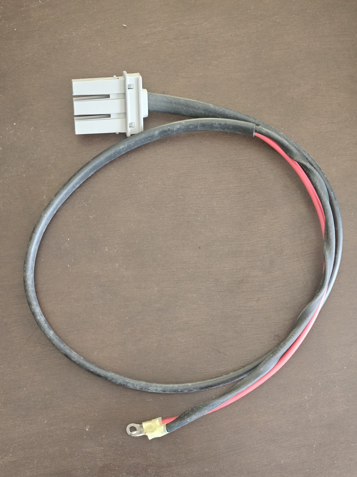

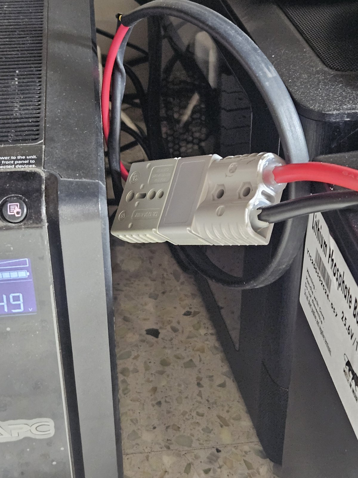

I was wondering how I would connect the battery to the UPS, but then I came across this.
The exact external battery connector cable, being sold in retail market for 900rs (from an online shop called estorewale, here in Bangalore). Ordered, arrived in a few days. Has a sturdy connector, and 10AWG wires. The connector has 3 pins, labeled +, - and s, with s shorted with - on the other end, probably used as a sense pin. The connector being sorted, it was time to actually make the big purchase, the battery.
Went through some suppliers on indiamart, some unresponsive, some quoting outrageous prices, and one trying to sell me (possibly) C grade cells, with the assumption that at most I’ll get 80% capacity from the get go. I had 2 choices here, either build the battery from bare cells, bus bars, bms etc, or simply buy a pre-built battery. I did not want to invest a lot in tools/time actually building the battery and possibly mess something up while doing so. Found one supplier who were promising, prices were decent, and finalized a deal. Cost me 37k all inclusive (battery, gst, shipping) for a 24v (8s) 100Ah LFP battery with metal enclosure, Daly 100A smart bms with BT. They took 2 weeks to make the battery and deliver to BLR, but the battery arrived in good condition. It arrived in a sturdy metal enclosure, 6AWG (copper?) cables and 120A anderson connectors, weighs probably around 20kg, has a nice spring loaded handle on top. The only downside I see are the rivets, as that makes the cells/bms inaccessible (unless i drill them, which is dangerous with charged LFP cells inside), but they do offer a 3 year warranty (not sure if you’ll be able to claim it if anything goes wrong) so the rivets sort of makes sense.

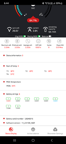

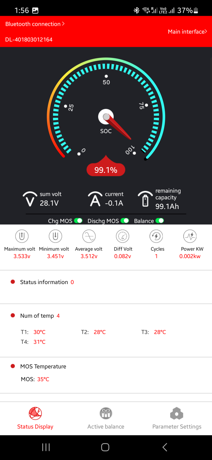

The BMS does have a bluetooth module though, but it goes to sleep after an hour (can be changed) if the battery is idle. I had already ordered some 120A anderson connectors from sharvielectronics, but until they arrive, this is the sketchy setup I’ve done to activate the bluetooth module/charge the battery. Upon connecting to the BMS, the app asked for a passcode, which I had to pester the supplier for, but eventually they provided it, and I had full access.
The BMS has 4 cell temperature sensors and a MOSFET temp sensor. Surprisingly enough, all 8 cell voltages are very close, with difference of 1 milivolts (!!). Did not expect this at all. And this has not drifted as the battery charged from 49% to 64%. The supplier probably used matched cells, did a top balance and then discharged the battery (or the voltage sensors are faulty). It’s charging fine with the UPS. Also, turns out the UPS does not require main batteries to be in to work, so I can remove the lead acid batteries entirely (does not require disassembly, just need to slide them out), and don’t have to worry about 2 different battery chemistries in parallel.

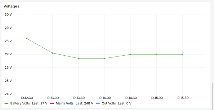

I have a similar issue with LA batteries in inverters, my Luminous inverters signal a low voltage alarm at 11.5V per battery and cut off load abruptly at 11.4V. I’ve setup battery monitors that trigger shutdowns before this voltage is reached. LA voltage levels also “bounce back” a little bit after the load is decreased so the inverter never actually shuts off. If a system fails to shutdown, then yeah, the inverter cuts off power abruptly. But I do not know if LFP’s have a similar “bounce back” behaviour.

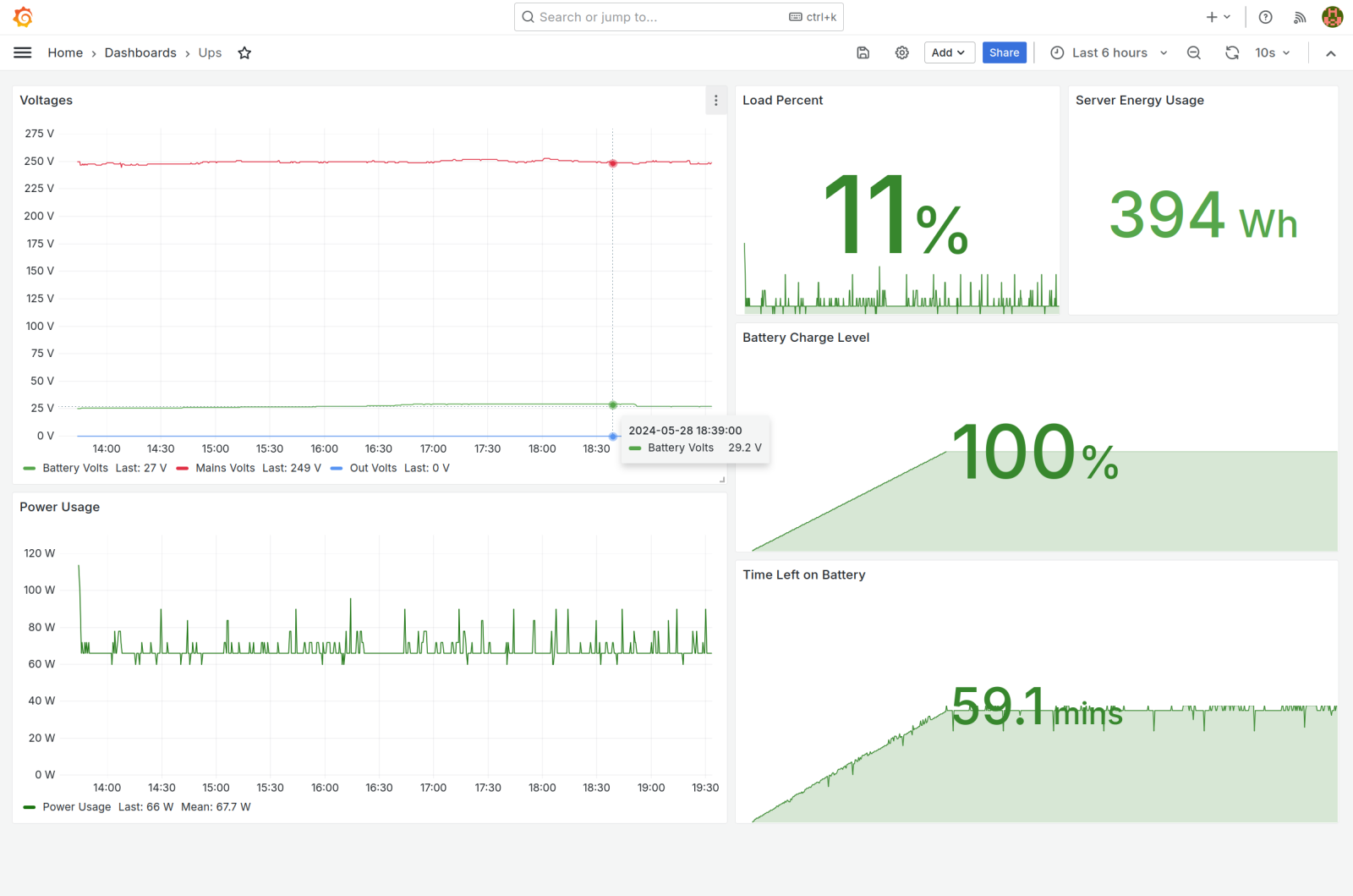

Arrow points to the moment where shutdown is wrapping up. The reading after that is the “bounce back”, this is for a two LA battery 24V system. If it drops to 22.8V, the Luminous inverter would cut off power.
But in this case, using 100Ah battery pack with a 70W load, this will probably never happen (BMS low voltage disconnect). You might even be able to move the entire setup to a cart/trolley, and keep your homelab online while switching houses — if you’re chasing uptime stats like me:

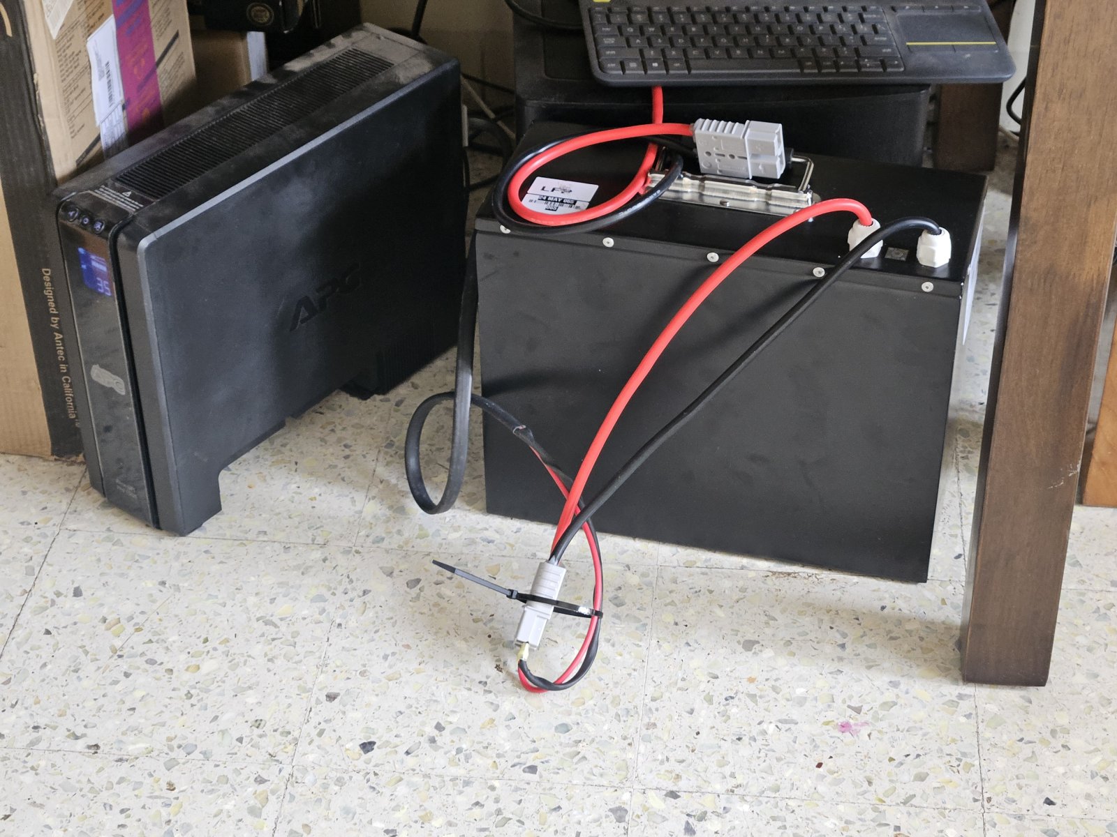

The anderson connector arrived yesterday, but man the lugs are heavy duty af. My tools were almost not enough for a good crimp, had to use a lot of elbow grease, but it was done. Crimp looks solid enough, and finally connected the battery with a less sketchy connection.
Will probably fill the wire side of the connector with 2 part epoxy. Started charging the battery, while closely monitoring the voltages, and stopped charging overnight in case something went wrong. My UPS has an average charge current of ~3A, took ages to reach full (?) charge.

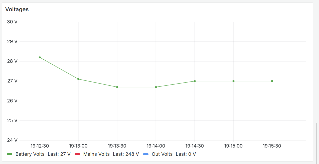

I was monitoring voltages closely, and charging turned off at 28.2 volts, not 29.2. I suspect the UPS monitors the charge current and once it reaches a low threshold, stops charging the batteries. 28.2 is still >99% for LFP 8s battery pack, provided cells are balanced.
As you can probably see, they’re not that well balanced at the top of the cycle, with one cell (8) tracking lower voltages. 82mv is not great, not terrible, but this probably would’ve reached higher numbers had the UPS charged the battery till High voltage disconnect. And the BMS is trying to balance the cells, so hopefully they’ll be in equilibrium soon ish.
The UPS however worked great for charging the battery, it did not overcharge the batteries, or hit high voltage disconnect of the BMS, as the low charge current threshold (presumably) was hit earlier than SLA batteries. However, I am seeing a 0.1A discharge with no load on the UPS (and mains power), not sure if that’s due to the differential of UPS float voltage (27v) and battery voltage (>27.5v). Something to investigate I suppose. Upon closely looking at the graphs, I can see that after full charge the SLA battery voltage drops to 26.6V and then gradually goes upto 27V, where it floats, hence could be an expected behavior.

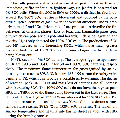

As @@rsaeon has mentioned, if the charger keeps the charge voltage below HVD but close to full charge, charge current will drop to near zero. EVs do catch fire, but those would be using higher energy dense NMC cells, not LFP (Recent EVs are switching to LFP for increased safety) . LFPs do not out-gas H2 below 100% SOC, and that too will only do so at >150c temps. Conclusion from
https://www.sciencedirect.com/science/article/abs/pii/S2352152X20315516
has the relevant info.
For thermal runaway to start, cell temp has to reach such absurd temperatures that something else has to have gone wrong catastropically, for example the BMS failing to trigger HVD or over temp disconnect, as well as the UPS kept charging beyond its normal parameters. I consider the risk of that happening to be within acceptable parameters.

This does not seem to happen in my case, where the float voltage is lower (~27v) and the UPS stopped charging before HVD. I will admit this was a case I was concerned about.

It’s important to note that you cannot get a ‘thermal runaway’ situation with LFP chemistry. You can physically puncture it, or intentionally set it on fire but it won’t self propagate. It’ll eventually fizzle out and stop burning when all the electrolyte is burned off, just like everything else that catches fire (wood, etc).
Lithium Ion (NMC) cells are at risk for thermal runaway because of their chemistry, specifically Cobalt.
You can cause a LFP cell to overheat and eventually start a fire if the BMS fails and a cell is supplied with a voltage higher than 3.65V for a extended period of time, but that is why a BMS needs periodic/daily monitoring in the case of higher capacity LFP packs. This is less vital for smaller packs since again, LFP combustion is not self propagating.
There was/is an ongoing discussions of this on other forums, here’s one of them:
There’s a few videos/photos linked in those pages that show what you can expect with thermal events involving LFP chemistry.

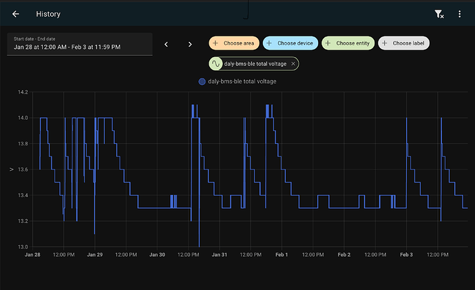

This is how the chart looks like over a few days - this is for a battery connected to a standard lead acid inverter . This is for a 4S battery so it hits a peak charge of around 95% on a lead acid profile. You lose around 5 maybe 10% of overall capacity but that should anyway help with longevity.

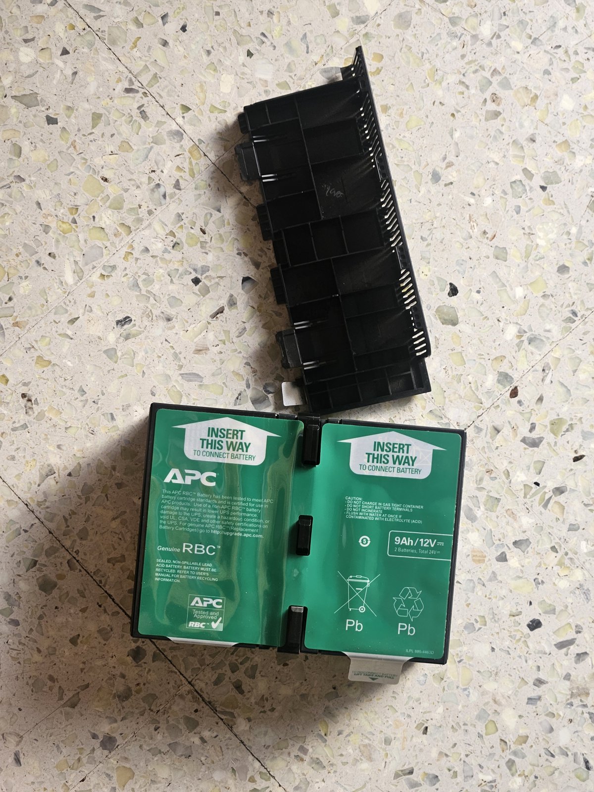

One last thing - the peak charging current capacity of your UPS will be kind of low for this pack since it appears to be designed for 14AH batteries
So its just 9ah on apc now?
9Ah at 24v, yes. Though the batteries have really degraded, barely provides ~10min at 100w ish. Doesn’t matter as the UPS is simply providing fast transfer time, and then the inverter kicks in.
