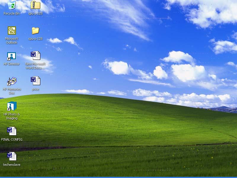

please look at this image maximized.
help.
For @hardboy:ur card is overheating and/or ur video card’s ram is fried.
