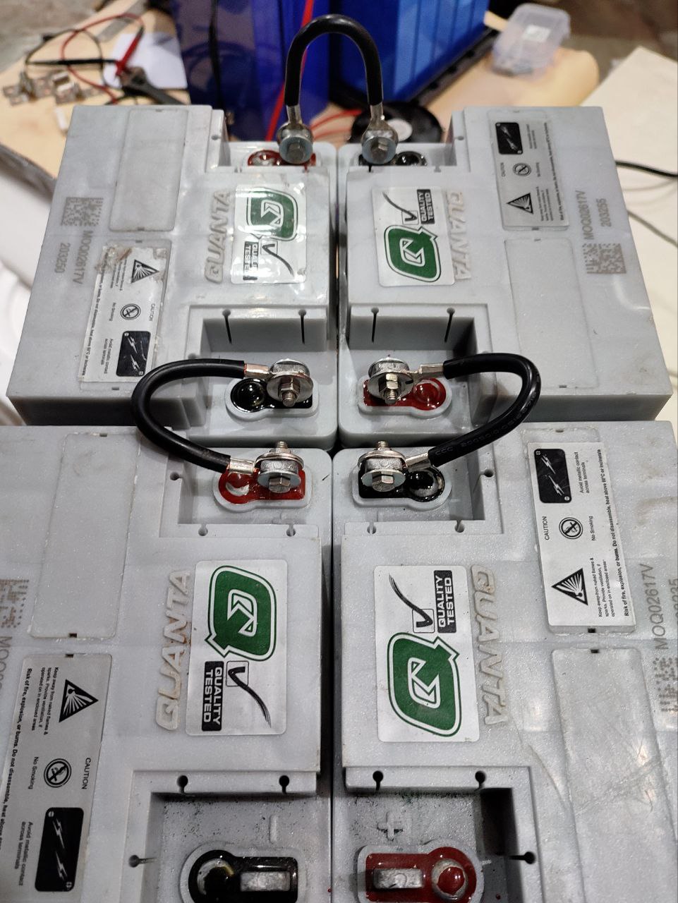

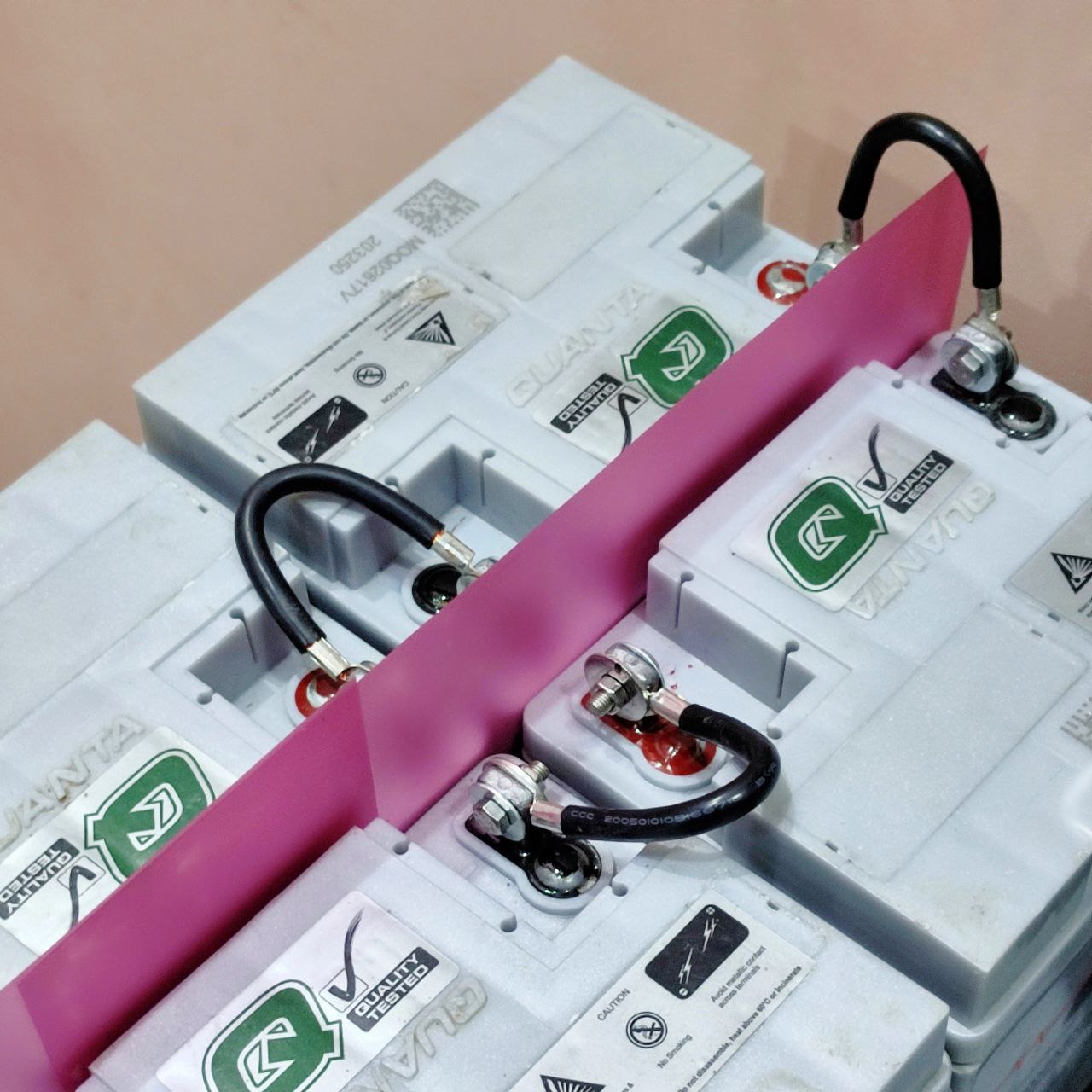

I used some scavenged 10 sq mm from the MuscleGrid battery’s BMS to make the connecting cables, since this is essentially a budget/temporary solution I didn’t go all out with new hardware or even heatshrink.
Just reused what I had:
Again, this (admittedly attractive aesthetic) layout/configuration is not at all recommended — it’s not only dangerous but probably borderline criminal in some countries. Any tool or metallic object could fall in between the terminals and cause a short, leading to a fire.
The terminals should be placed on the outer perimeter of such an arrangement, I didn’t have enough wire for that (all connecting cables need to be of equal length).

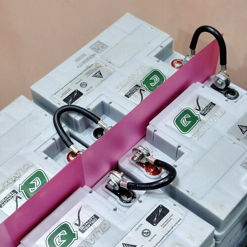

Instead, I put in some plastic sheets from a file/folder as an insulator between the two halves of the battery bank:
I test-dropped some wrenches and screwdrivers on the batteries (never do that) and it worked well, the plastic is tall enough over the batteries that it folds down to one side and completely covers the terminals when something falls down on it.

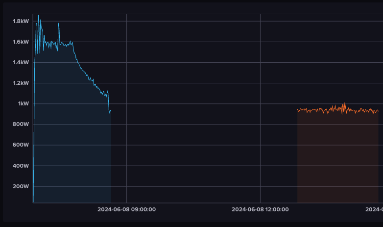

An unforeseen but obvious complication with a double inverter/ups setup is increased power consumption, I was able to quantify just how much yesterday after a 30 minute power outage.
If I understood the numbers correctly, this setup of dual inverters used ~750W of power to recharge the batteries that provided ~450W for an efficiency of 450/750 = 60%.
In absolute numbers, that’s an excess of ~300W consumed or Rs 3.5 billed (at Rs 10.5 per kWh) for that ~30min power outage.
Blue being the power draw during charging, orange being typical power draw over the same length of time later on in the day.
I used InfluxDB’s [ICODE]integral(unit: 1h)[/ICODE] function to calculate the area under these two graphs to get Wh (?) consumption numbers:
normal _field _value _start _stop
Power 1711.57270361111 2024-06-08T12:50:00.000Z 2024-06-08T14:40:00.000Z
charging _field _value _start _stop
Power 2458.78310972222 2024-06-08T06:50:00.000Z 2024-06-08T08:40:00.000Z
So that’s 2458 - 1771 = 747W total power used for charging.
Power used during the power outage was derived from the normal usage numbers, 1711W for 110mins works out to be 1711 x 30/110 = 466W for 30mins.
Subtracting that from the power used for charging and we end up with 747 - 466 = 281W excess power consumed during charging.
Or I could be wrong. I got 12/100 in Botany & Zoology so I hope these calculations are at least a little bit correct.

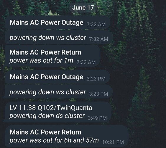

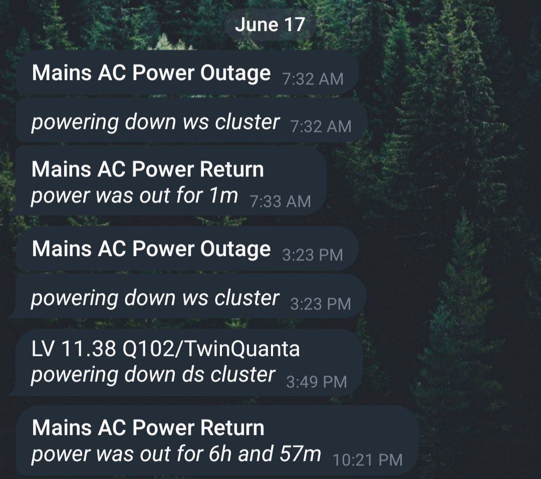

Vindicated! The dual inverter setup performed admirably today.
The non-essential cluster is shutdown immediately during a power outage, while the 1kW cluster is shutdown when either of the two 100Ah batteries falls under 10% SoC (~11.5V) — that’s after 26 minutes in the screenshot.
But there was enough power in all three battery banks (1x 100Ah, 2x 100Ah and 4x 26Ah) to run the essential cluster (home wifi, cameras and automation) along with fans and lights for another six and a half hours!
And yeah, we had a 7 hour power outage today. I had to switch over the load of general purpose inverter with a single 100Ah battery (it powers lights and fans) to this setup halfway through. The lights and fans are in my parent’s rooms so they were comfortable the entire time, which makes all of this worth it.

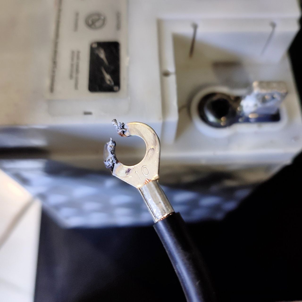

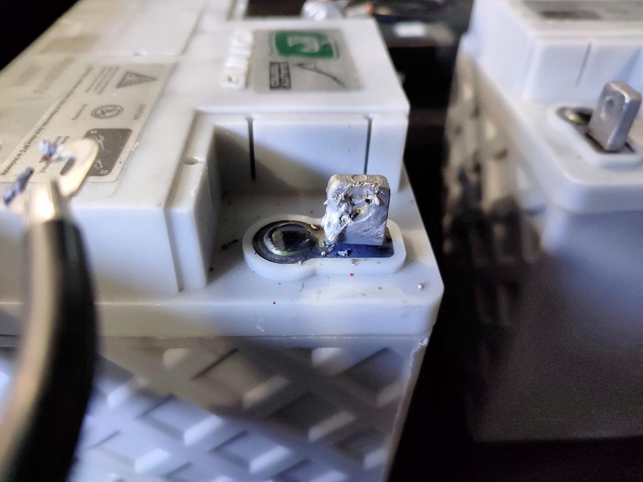

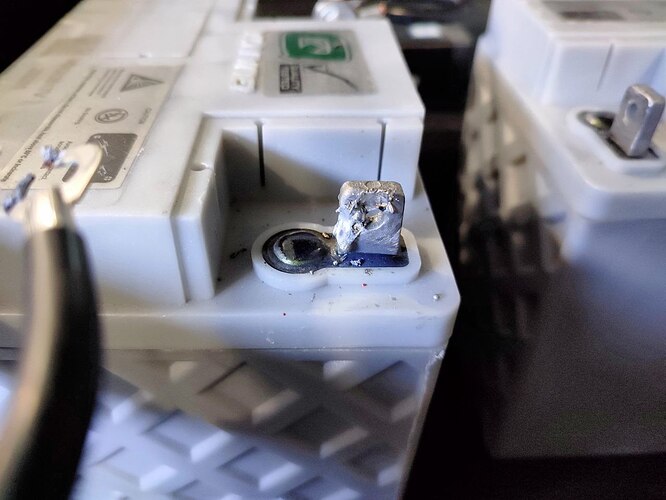

Got a reminder today just how precious life is:
This happened when I was disassembling the battery bank to move it to a different shelf.
I started by disconnecting the connecting wire that’s half way in the bank, this is the recommended way as it would break the series batteries in two less dangerous halves.
What I didn’t do is not making sure the wire was completely free of the terminal, because just disconnecting isn’t enough. Preferably temporarily insulated until the move was done.
So when I went to remove the other connecting wires, the wrench shorted the two halves and this loosely touching terminal arced and melted along with part of the battery terminal.
Of course this happened when I was rushing through the process because I didn’t want to be without backup power any longer than necessary.
But then what’s the purpose of backup power if you’re dead?

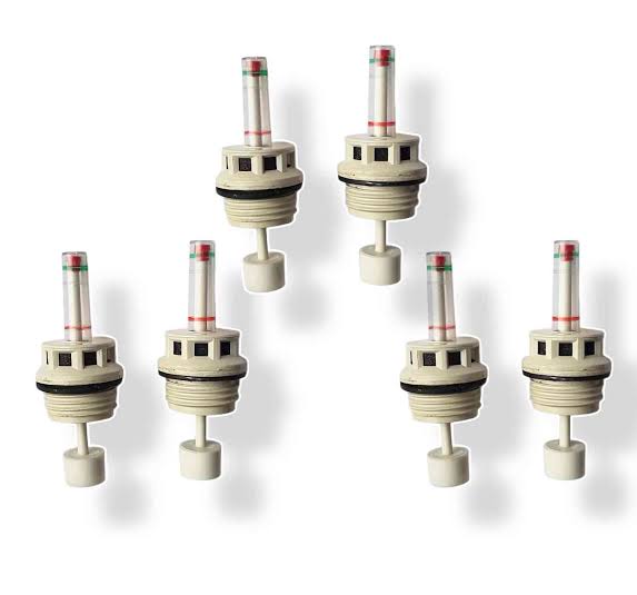

guys is it possible to monitor these inverter batteries water level remotely remotely in sense that it it makes a sound or something when the levels go below a specific level?
The 2kva Luminous inverter I got sometimes trips and shuts off due to overloading, and I needed to monitor that, so I set up a simple ESP32 cam pointed at the display ha. It works well enough but a maybe an actual security camera would be better and cost a little bit more, around 1k.
I guess you could use an ultrasonic sensor to measure the water levels but that might end up costing more since you’d need a sensor for each of the cells and the smaller ones that’ll fit inside the fill port are expensive.
there are other water sensors that can sense water at a particular spot or level but again, a camera would be more cost effective.
