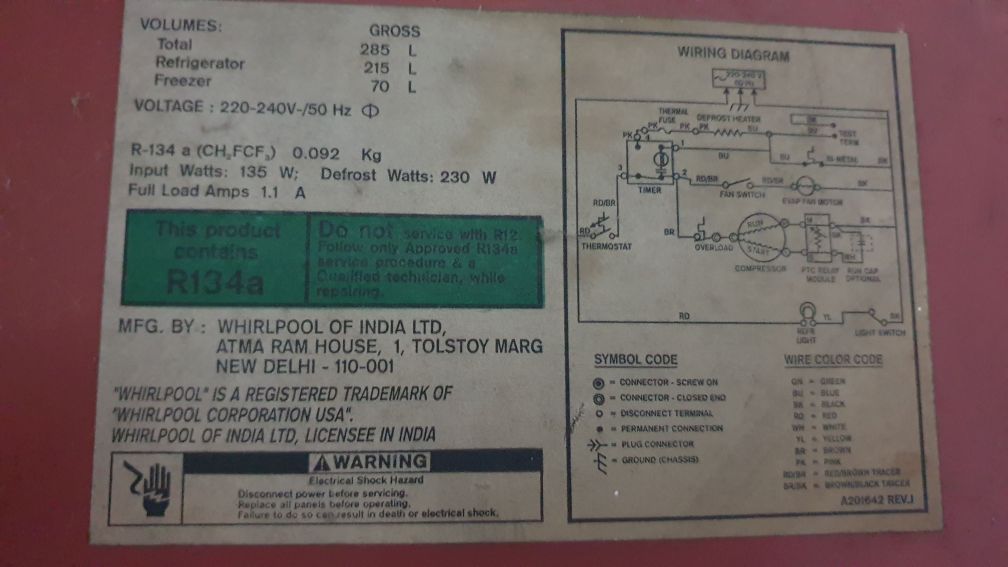

Look for a ratings label either inside or on the back of the fridge. Take a photo of it and post here.
Hope this is enough. It says gross ltr.

Hope this is enough. It says gross ltr. If I could get a ballpark on its actual capacity then I can narrow my choices.
It says 285 gross means just that without shelves. So look at models larger than that in the shop and decide which size you want.
