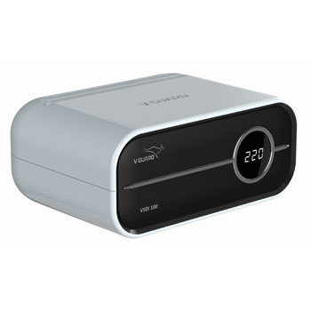

I would also like to what capacity stabilizer do I need to get for it.
Depends on the quality of power you get. I saw the liebherr says it works from 100 - 285V which is a wide range.
Can't tell if the Bosch fridge has a built in stabiliser or not? But the Liebherr does.
I'm not sure then what happens if you daisy chain stabilisers? Generally the advice is not to do that. It increases power consumption unnecessarily for one since inefficiency of both stabilisers has to be considered. Assuming efficiency of both is 90% you lost 10% for nothing adding a second stabiliser in series
Any idea @lockhrt999 ?
True I didn't find them. I asked them to visit Bosch showroom too and noted it to ask the salesperson there. Power has been stable in that area, fingers crossed but still worry.
If the Bosch model has an inbuilt stabiliser with a good working range like you mentioned, can we skip the need for stabilizer. This is important since the fridge by itself is tall and if we are to keep the stabiliser over the top then it would be difficult to see.
The stabiliser working range I quoted is for the liebherr not Bosch. There is no indication on he website whether bosch has a built in stabiliser or not. You will have to confirm that. And if it does then no need for an external stabiliser for the reason mentioned in my previous post.

VSDI 100
VGSD 100
are our current choices. Any inputs over these two. The Fridge is to come from factory direct by Thu or Fri.
So the stabiliser purchase will be later. The Height will be an issue. They have a loft above the fridge space. Not sure of the gap for the stabiliser.
