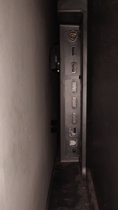

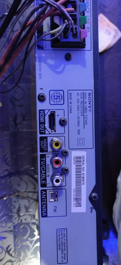

Can you share the pictures of the ports on both TV and home theatre?. Most probably you are connecting both inputs ports. I mean on the TV those RCA ports are composite input and they are meant for input only. And the ports on the 5.1 sound system is also for inputs.
While the port on the monitor is an AUDIO OUT and hence it is working properly.

Well this is it. I have searched for a solution, some of them mentioned about DAC. Sorry my TV is already attached can't move it. Sony Home theatre TZ145 & Oneplus 65U1S TV.

Buy a 3.5 mm to RCA cable. Something like this
Put the black end inside the last port of the TV and the RED and White jack to the corresponding jacks on the home theater. Choose your input audio mode is home theatre to RCA / TV / Cable. That's it. you will hear Tv sound in speakers.
But note in this method you will get stereo sound only. That audio port is NOT capable of transferring 5.1 channel sound. Only a stereo is supported.
You will have to use RCA to RCA male cable from STB to the Sony system. That sound system doesn't even have HDMI input or optical input ports to get 5.1 audio. So you will have to use it as stereo system only.

Have a look at the specs
It's clearly mentioned as AV input, also mentioned in the given accessories its "AV in adapter". So there is no analog audio out available in your TV. You have to use an active converter for optical to stereo out like this one FIIO - D03K
My mistake. That small port is actually mini composite in. And not a headphone jack. Your best bet is to convert the optical audio into RCA as rightly pointed out by @gourav.
You take the optical output from TV and connect it to the converter. Then use the RCA output of the converter and connect it to the input of the home theatre. You will also need to go into the TV sound setting and choose OPTICAL / PCM output as disable the TV speakers.
You will ABSOLUTELY need a DAC as your TV has only digital output and your home theatre has only analog input. So a DAC is essential to connect these two.
