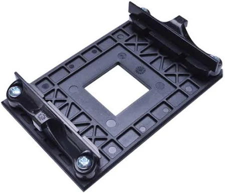

Hello,
I have an old Zen2 build with Corsair H100i AIO installed. The build wasn't in use as I couldn't carry it with me when I relocated. After an year or so it looks like the coolant froze and it's unable to maintain operating temps anymore. I have considered going back to stock cooler but to my surprise I have misplaced both the backplate and the mounting bracket that came with my x370 motherboard. I've looked on amazon but they require a couple of weeks to deliver (guessing it's shipped from overseas) and customs delays might add to it.
1. How difficult is it to replace the coolant in the AIO considering it's a closed loop without a drain valve. Anyone with personal experience or a guide on how to go about it?
2. I was wondering if I could get recommendations for a reliable retailer that I could source the backplate and mounting brackets from? preferably seller based within India
