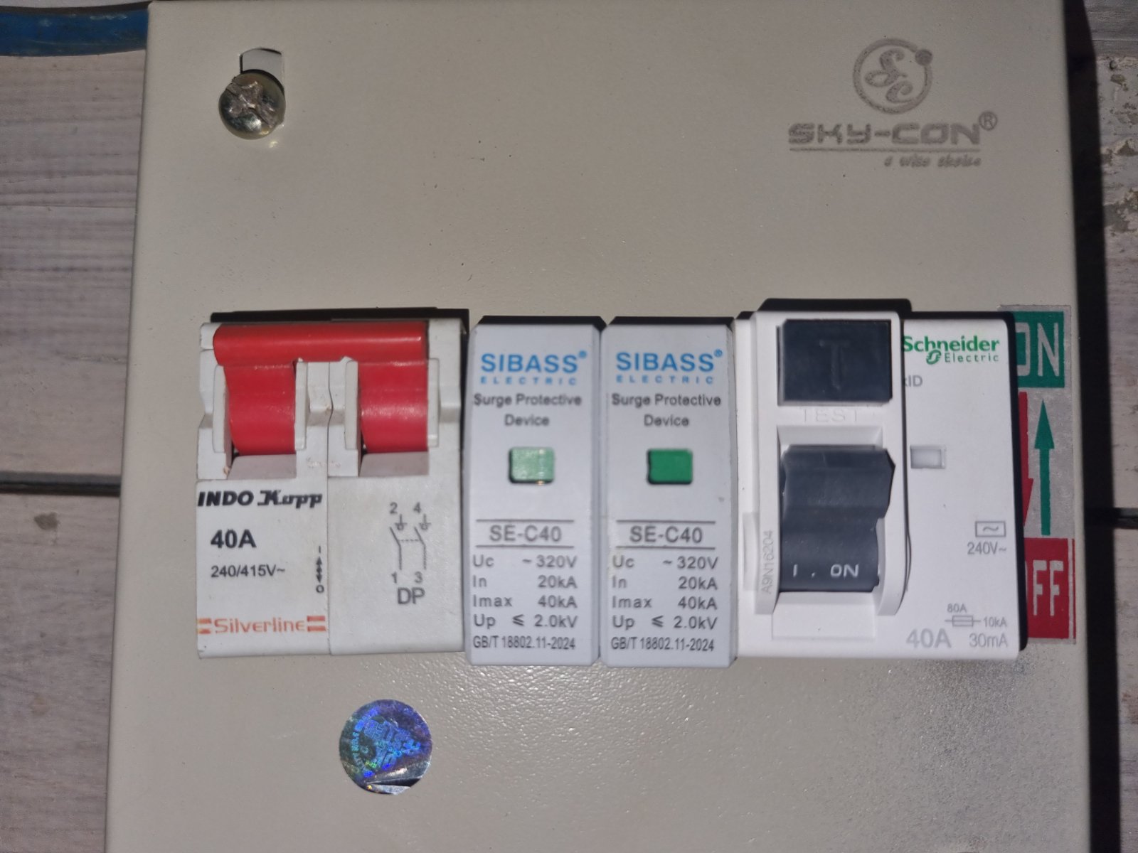

Is this good?
Get schneider, havells rccb. Ampere rating according to your load.
For spd I use this: spd
I doubt that amicismart rcbo will last. It's better to use dual-pole-mcb/isolator+spd+rccb

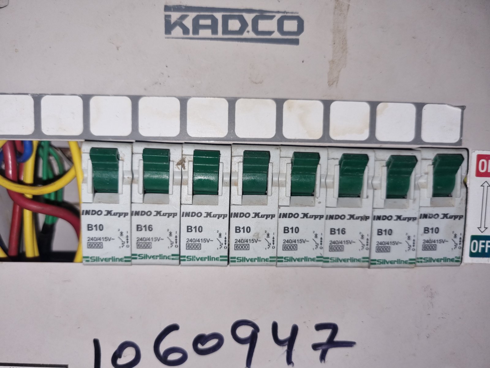

So this is how the setup looks like now. Is it normal for rccb to not trip, when we tried purposely tried to shortcurit by touching to wires that were plugged in? Instead of rccb these green 10A mcbs were tripping.
Only a RCBO or a mcb will trip in a short circuit. RCCB will not trip.
Reactions: grenade0
When short circuit occurs (phase + neutral), it quickly develop very high currents - This trips MCB. Short circuit causes very high current instantly, not necessarily imbalance between phase and neutral.
Current imbalance between phase and neutral trips RCCB. i.e Loose Connection in sockets, plugs, accidental touch of any wire.
There will be a "Test Button" on RCCB, push it to test if RCCb is working or not. If RCCB trips on pushing test button, its working.
