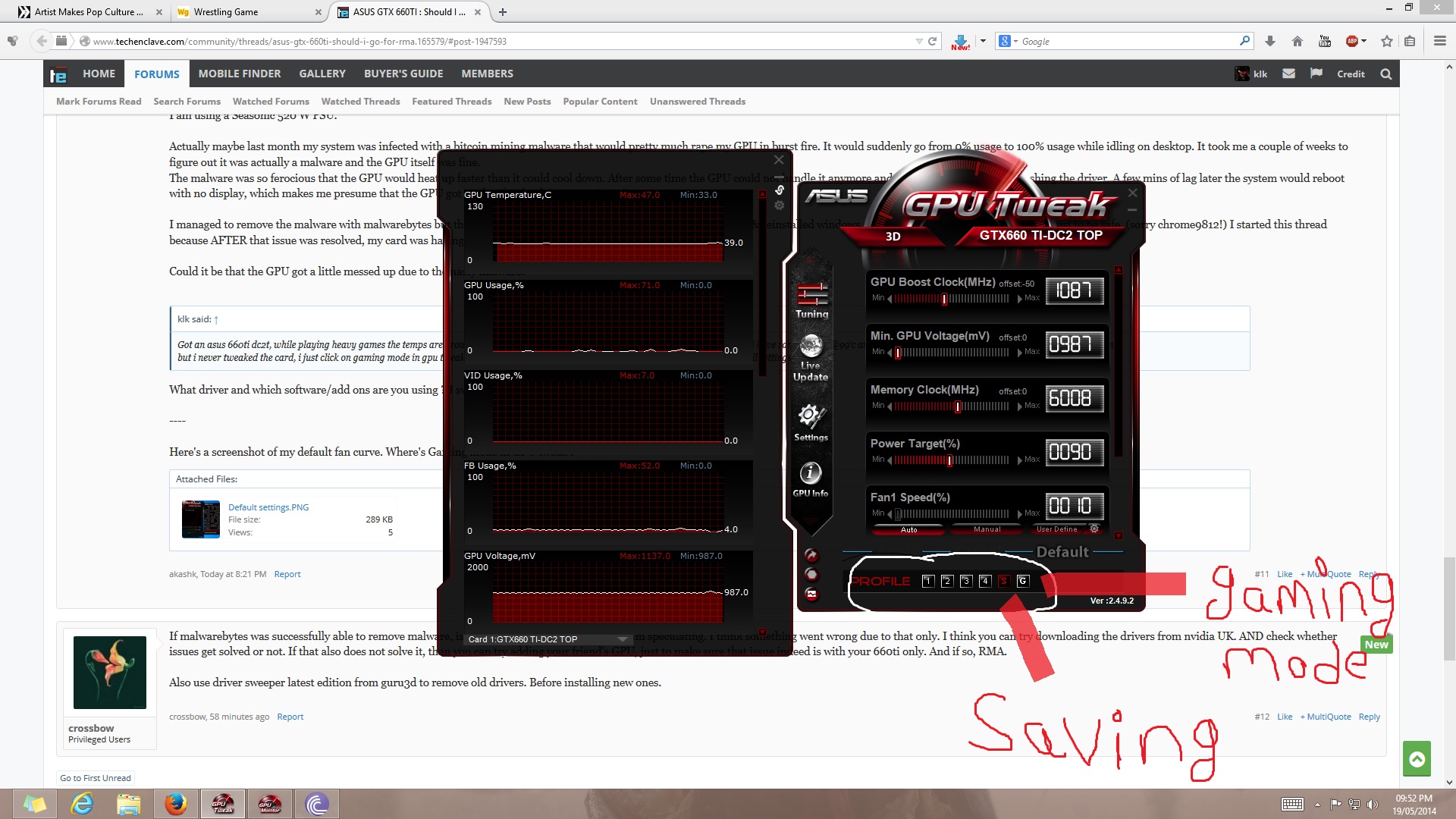

What driver and which software/add ons are you using ? I swear my GPU never crosses 80 without crashing !
Here's a screenshot of my default fan curve. Where's Gaming mode in GPU tweak ?
If malwarebytes was successfully able to remove malware, issue should be solved. But again, I am speculating. I think something went wrong due to that only. I think you can try downloading the drivers from nvidia UK. AND check whether issues get solved or not. If that also does not solve it, than you can try adding your friend's GPU, just to make sure that issue indeed is with your 660ti only. And if so, RMA.
Also use driver sweeper latest edition from guru3d to remove old drivers. Before installing new ones.
see the screen shot , but my card is 660ti dc2t the top edition card , also do what crossbow said and also try inserting gpu in other slot and see if the problem stays[DOUBLEPOST=1400516903][/DOUBLEPOST]tech.jpg
see the screen shot , but my card is 660ti dc2t the top edition card , also do what crossbow said and also try inserting gpu in other slot and see if the problem stays[DOUBLEPOST=1400516903][/DOUBLEPOST]View attachment 40708
Wow, I just realized there are 3 versions of the card. I have the basic DC2 card and I guess the others have slightly better architecture and higher factory overclock.
I just realized I have G mode too, but for me the offset increase is 20 in GPU boost and 40 in Memory clock. Maybe that translates into 1 FPS more, not worth the hassle of switching modes back & forth.
Thanks for the screenshot.
buy another 66oti and do sli ;) if u want more fps , there is one 660ti dc2t on sale in forum
