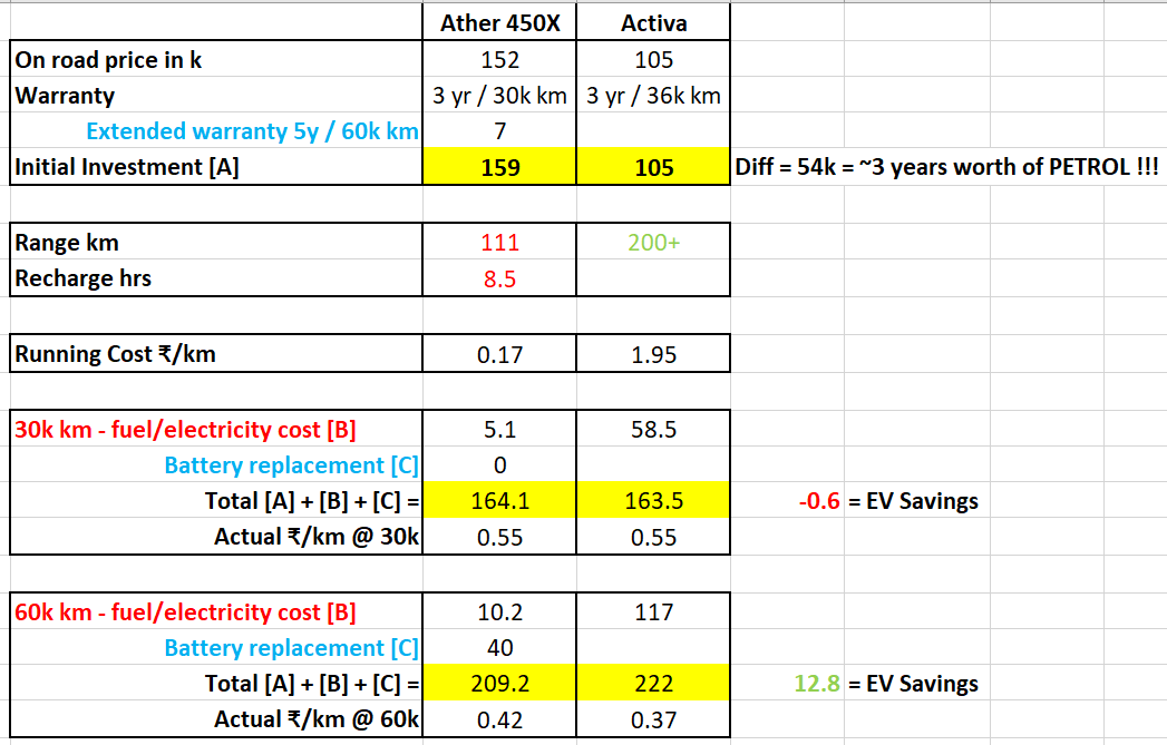

Considering only the petrol vs electric running cost doesn't tell the full story.
Here's some rough numbers:
  • For the purchase cost of the Ather 450X, you can buy an Activa AND not worry about fuel for 3 years!
  • Without the Battery Warranty Addon (7k), you will be spending most of the EV savings on new battery every 3-5 years.
  • Let's say your original battery dies after 6 yrs / 60k km. Since it's out of warranty, you'll have to pay 40k. That reduces EV savings to 12k over 6 yrs or 500 bucks per year. Makes no financial sense at all
That said, if the lower range + longer charge time doesn't matter to a person's actual usage scenario, people should absolutely switch to electric. Petrol price will only go up. Battery price will only come down.
But electric cost is rising too, and most people use street parking where it may not be possible to install a charger.
PS: Servicing cost is not included, if anyone has accurate numbers for both, please let me know
Edit: This random video seems to claim higher prices for the battery
Not able to make head and tail out of this. Very nice of you to conveniently add 40k for battery change at 60k and not add any cost of replacing worn out parts for an ICE or how scooters lose mileage or how peteol price is going up.
I had Honda aviator and it would barely give 35kmpl by end of 3rd year. Service every 3 months is such a pain. Honda says services are free for 2 years whatever but they make sure you pay for something at each service every quarter. This is well known fact. Bikes are so much better in this regard.
Whether you believe are not, ICE scooters are far less reliable than bikes and their mileage sucks from fourth year and part replacement cost is also higher compared to bikes. For an EV, the only change required is for brake pads and the belt if it gets too loose. Belt change too is very rated
If I feel that electricity price is too high, I can get solar power for entire home and use that to power up EV scooter. Can I do that with ICE?
Moreover, those changing battery at 60k is very rare. Like I said, I spoke to few 1st gen owners and they have not changed battery yet.
I am not surprised that so many have this battery anxiety about EVs. We look at these like how we look at phone batteries. A phone battery degrades in 2-3 years because it is in use every minute of the day. That is not the case with an EV. Also, even if battery degrades to 70% and gives 70km range, that is still more than enough for most. Normal battery change IMO is once in 7-8 years probably.
Sorry, this does not make any sense. By this logic, I can install solar charger and not worry about cost for entirely of life of EV. I am not going to get into iOS vs Android, PC vs console kind of pointless discussion.
Factually incorrect and you are assuming that every EV owner is changing battery 3-5 years. Mine is nearing 3 years and there is no way I am going to change battery. I will do one thing. I am not so active on Ather forum. What I will do is that I will drop a post there asking how many changed their battery.
Lets say ICE motor dies after 6 years. Since it is out of warranty, have to pay how much? I can also 'assume' that it will break.
OP wants to buy an EV which means that he has figured out charging already. This is not a thread about EV vs ICE.
For those who cannot charge an EV, there is no point of discussion. ICE is the only option.
