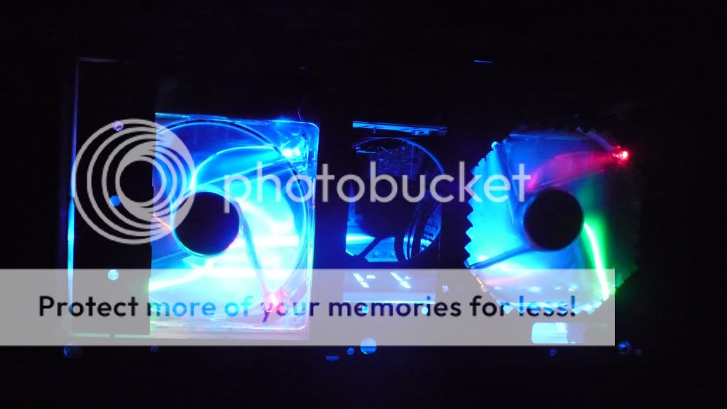

hiw ccan u expect from that side FAN to cool HDD?
firstly there are no holes for air intake for that fan & also it most blows over a solid metal potion :P ..........the FAN has simply No use . reconnect this fan to front of ur cabby as a intake FAN .
u are using side 120mm fan for exaust & also rear FAN are for exaust , so it careates negative pressure , but isn't enough to pull in air .
i can say : ur cabby has messed up cable management , messed up FAN setting .
what should you do ?
- remove fan from the side (which u have attached for cooling HDD, that FAN has no room for air) and connect it to front as an intake FAN .
-side 120mm FAN : so u say u cannot connect 120mm side fan when rear fan is in place right ?
attach 120mm fan to front intake & take 80mm fan(that was blowing over HDD) & use it on side panel as intake FAN .
- keep rear exaust fan as it is .
this will surely move air around .
for better results: u can get 120mm Amingo(if budget is low , they cost 175bucks) or some good quality (CM ,Schyte,etc) . get 3 *120mm FAN'S .
-attach one 120mm fan for front intake.
-attach second 120mm fan for rear exaust.
-attach third 120mm fan in 5.2" bay , as suggested by 'SidhuPunjab'.
-dump those stock Fan's , u can have very good airflow with only three of good performing 120mm FAN'S.
-if u are going to buy all Amigo Fan's then u will have bare the noise , Amigo FANS are very audible(we can say they are loud).
- u can have better cable management for good airflow.
This is how i use my FAN'S. all thre FAN'S are used for intake , & there are 2 80mm FAN'S for exaust . i have no FAN on side panel .
i have connected an 80mm FAN infront for intake in sapce for Floppy drive(as i don't use any floppy drive)
please bare with pic . i have posted it horizantally . ratate it by 90 .
