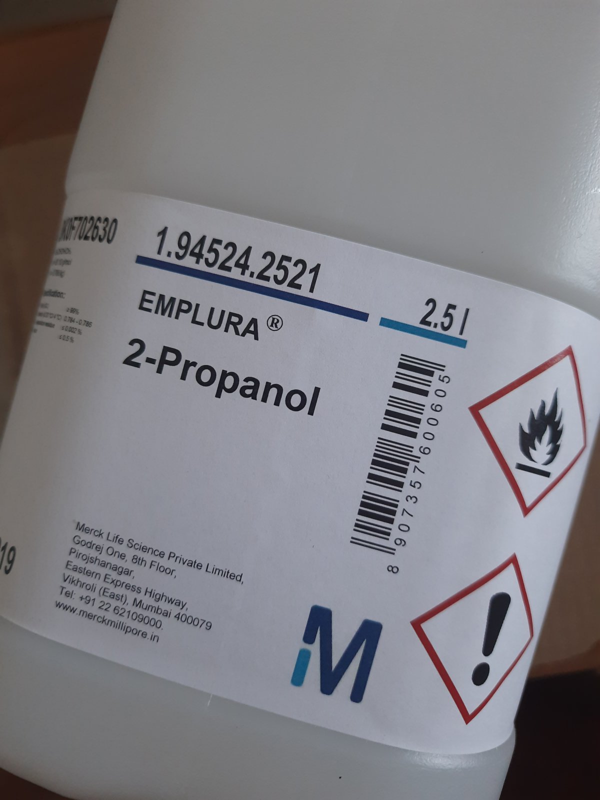

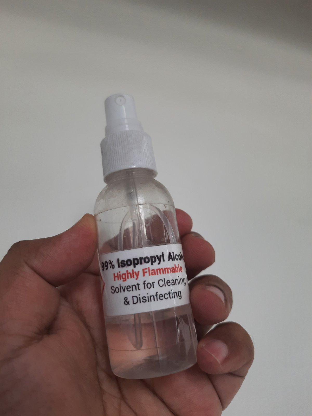

This is my stock that I use for resin 3D printing as well as cleaning just about anything electronic.
Emplura is the slightly lower quality line intended for lab work, but still quite high quality and cost me around 1950 for 2.5 litres. I go for this as it can be further diluted if your application demands. Available from nearby lab supplies place.
I always keep it handy in a small spray bottle.
