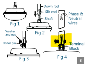

This issue is pretty common in conventional fans as well and almost every time the root cause is loose-fitting, either at the top of the down rod or the bottom of the down rod.Its stock rod that came with the fan. Amazon reviews are filled with similar complaints for this particular model. I installed it my self, so no question of loose fittings.
I had sorted out similar judder issues just by tightening the nut on the down rod, that is the reason I was confident about the fix.
If it appears snugly fit and still judders, then chances are it's not tight enough, you can still turn it a couple of threads to add that extra clamping force on the down rod.
Please give it a try, I'm pretty sure this works.
