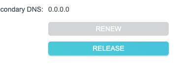

UPDATE: Got it resolved. The issue was dhcp was enabled on the GPON terminal as well, which was causing that issue it seems. Resolved it by disabling that.Okay I have successfully bypassed Jio ONT using the provided TP Link XZ000-G3 GPON unit. I have done the following things:

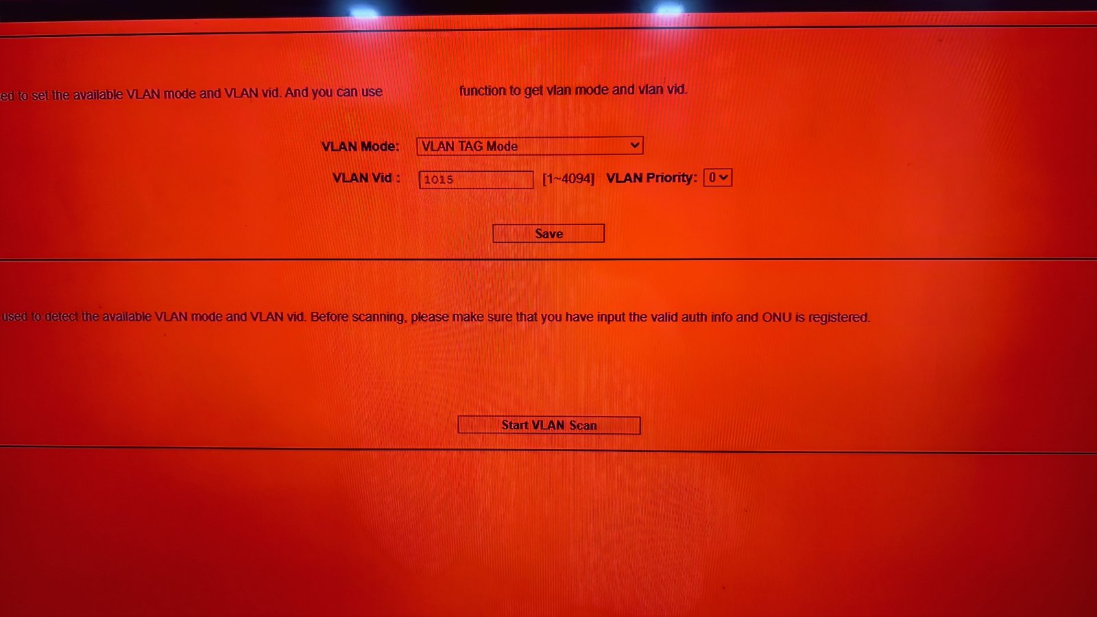

1. My JIO firmware starts with ARCN so I used that for the serial number
2. Converted it to hex and appended the last 8 digits of my mac address
3. Put that in GPON SN and in VLAN set the tag to 1015
4. I am using a TP Link Archer C6 v4 router where I cloned the MAC address of my jio router.
Connection got established. BUT I am facing one problem
Now if I restart my router and the GPON unit, I don't have internet connection. I don't get assigned any IP adress dynamically. (I have set dyanmic IP in my tp link router). To get my internet working I have to press release and renew in the router settings and then I get an IP assigned. How do I solve this?![]()
Hey I have vsol and arcn router too. Did you take hex of arcn only and added mac or whole hex of arcn + macOkay I have successfully bypassed Jio ONT using the provided TP Link XZ000-G3 GPON unit. I have done the following things:
Now if I restart my router and the GPON unit, I don't have internet connection. I don't get assigned any IP adress dynamically. (I have set dyanmic IP in my tp link router). To get my internet working I have to press release and renew in the router settings and then I get an IP assigned. How do I solve this?View attachment 238110
Reference steps: https://broadband.forum/threads/how...ssing-the-jiofiber-router.221140/post-1673568
Only the hex of ARCNHey I have vsol and arcn router too. Did you take hex of arcn only and added mac or whole hex of arcn + mac
