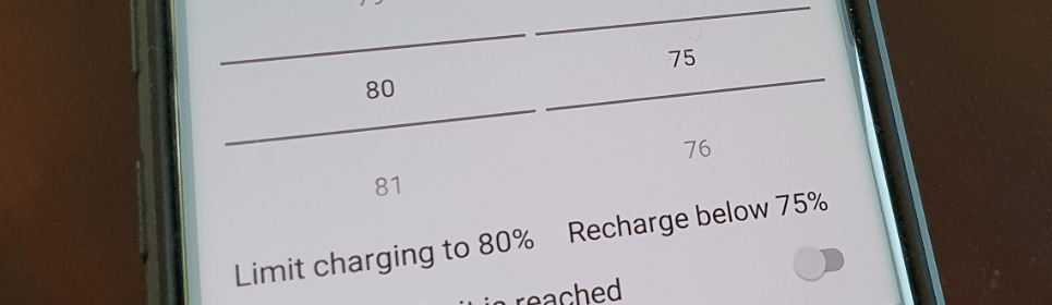

If you are rooted on Android then Battery Charge Limit can do it automatically.
If you are on Samsung, you can disable Fast Charging.
If you are on iOS, you can toggle 'Optimized Battery Charging' to On.
