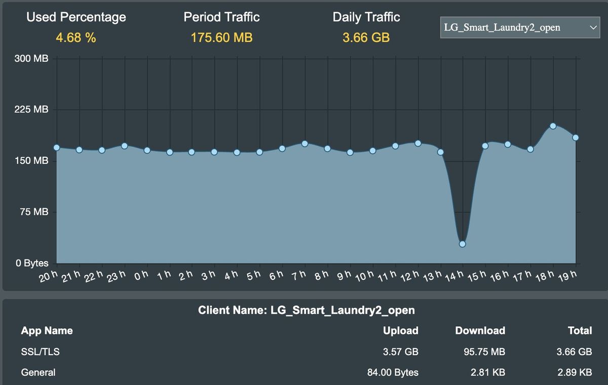

  1. The IFB App integration is average at best. Provides no information on usage of power and water in each wash cycle. Only let's you set the additional wash programs that are not on the front panel.
I've yet to see power consumption in an app for the washing machine even by LG. So far it isn't as granular as on their split AC's. I use a Meco power meter for power monitoring.
I haven't come across this Hot Rinse option yet.
Not showing power and water consumption on a smart enabled washing machine is a big oversight IMO. Hopefully they add it down the line but looking at the state of IFB's Android App and how it still refuses to pair with the machine, I won't be holding my breath.
