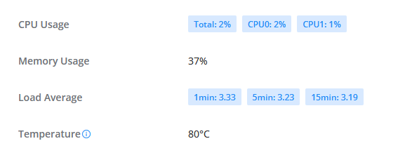

Could you share the system cpu temp? mine seems very high on gwn7002. also only first wan support ipv6 which is bad.
You are right. It seems quite high for idle.
I don't think it would matter though, as it is well below 125C.
Also a thing to note, mine sits in a network rack which inside a cupboard with 2x (filtered) intake and 2x exhaust 12V PC fans (Corsair). So very high ambient (should be close to 40C) temps.
I noticed that only now. Also, ipv6 on primary WAN isn't working for me as well (shows status as connecting - not sure what configuration I messed up and if it worked with other routers either). But I am not a heavy user and it didn't bother me till now.

yes it is sad few small things has been missed. otherwise it is really good. 2sfp port at this price range is not available. I tried opening it to replace the heatsink with copper one but it is hard. even with metal case it is high. mine is gwn7002, idle at around 70c when i use a mini usb fan.
you can see the report and can try replacing the heatsink if you are rich to afford second one. :D

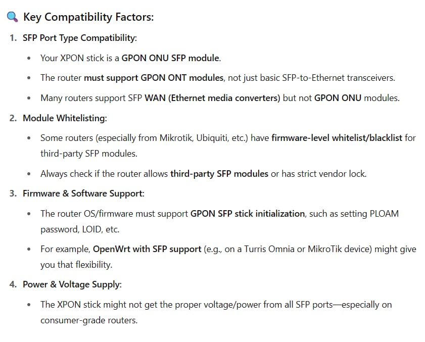

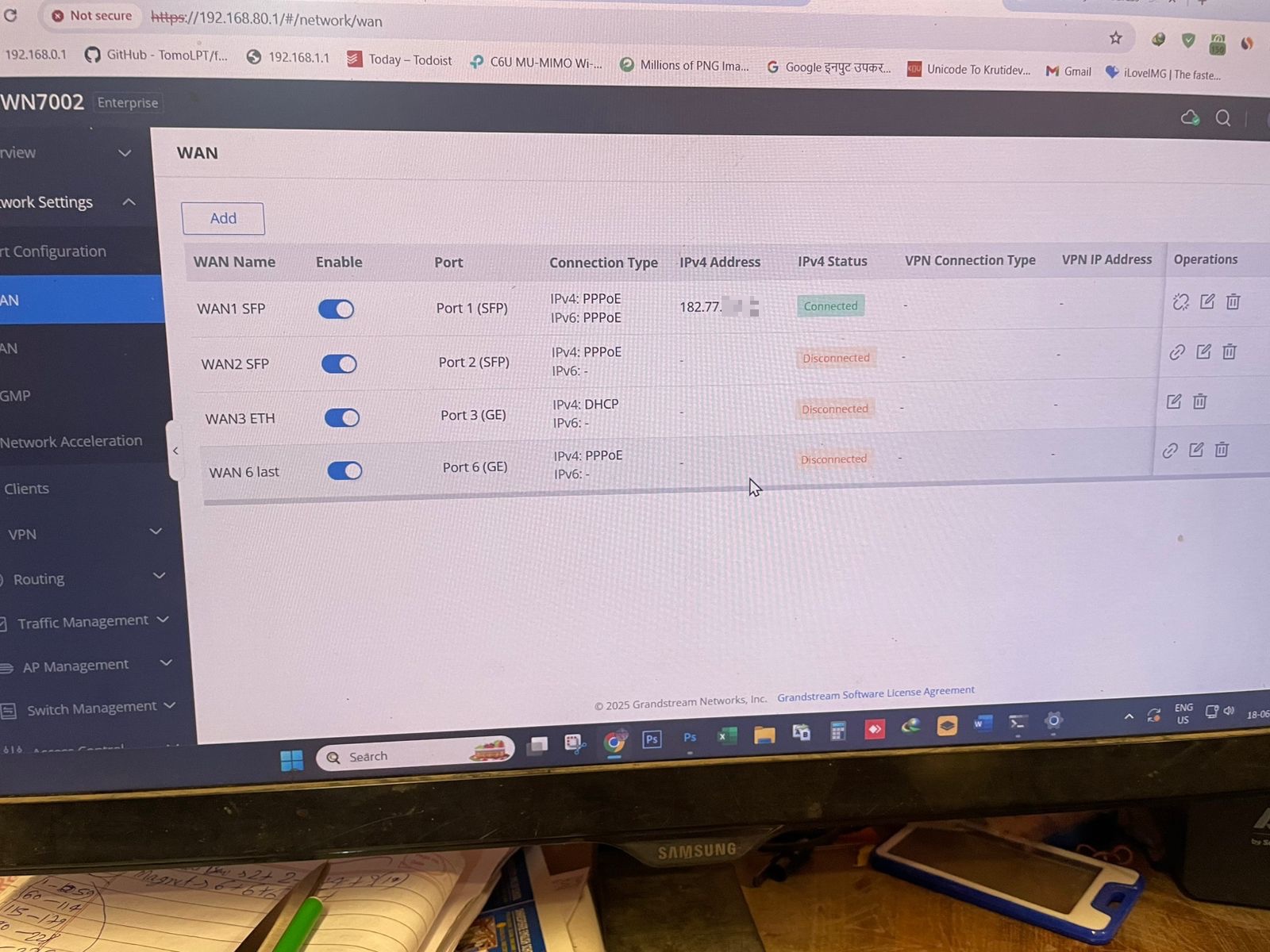

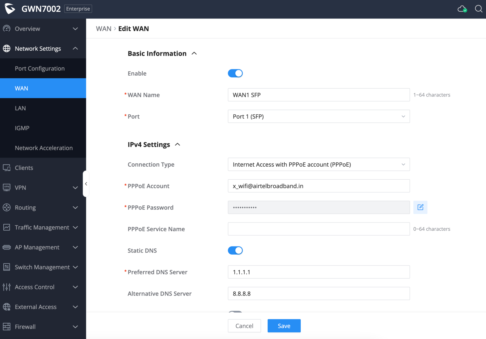

really? my main reason was to get gwn7002 to get sfp module for both main and failover isp however as i am still using my PTP device, i haven't got the chance. have you tried with a media converter before? sfp port is stupid if it will not work. i checked my WAN settings and it has PPPoe dial so it should work.
