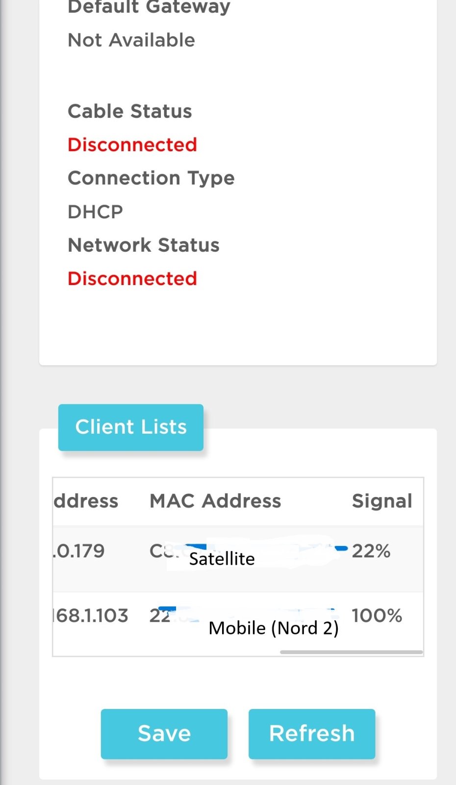

    • I plugged the router in one end and satellite in other end of the house. Did not connect any ethernet cable into the satellite. Bandwidth was ~30mb/s on fast.com, the main unit (router)'s status page showed 22% signal strength. The Satellite itself had blue light in the logo (indicating OK connection, not great).
      Screenshot taken on Nord 2, near Main Router.

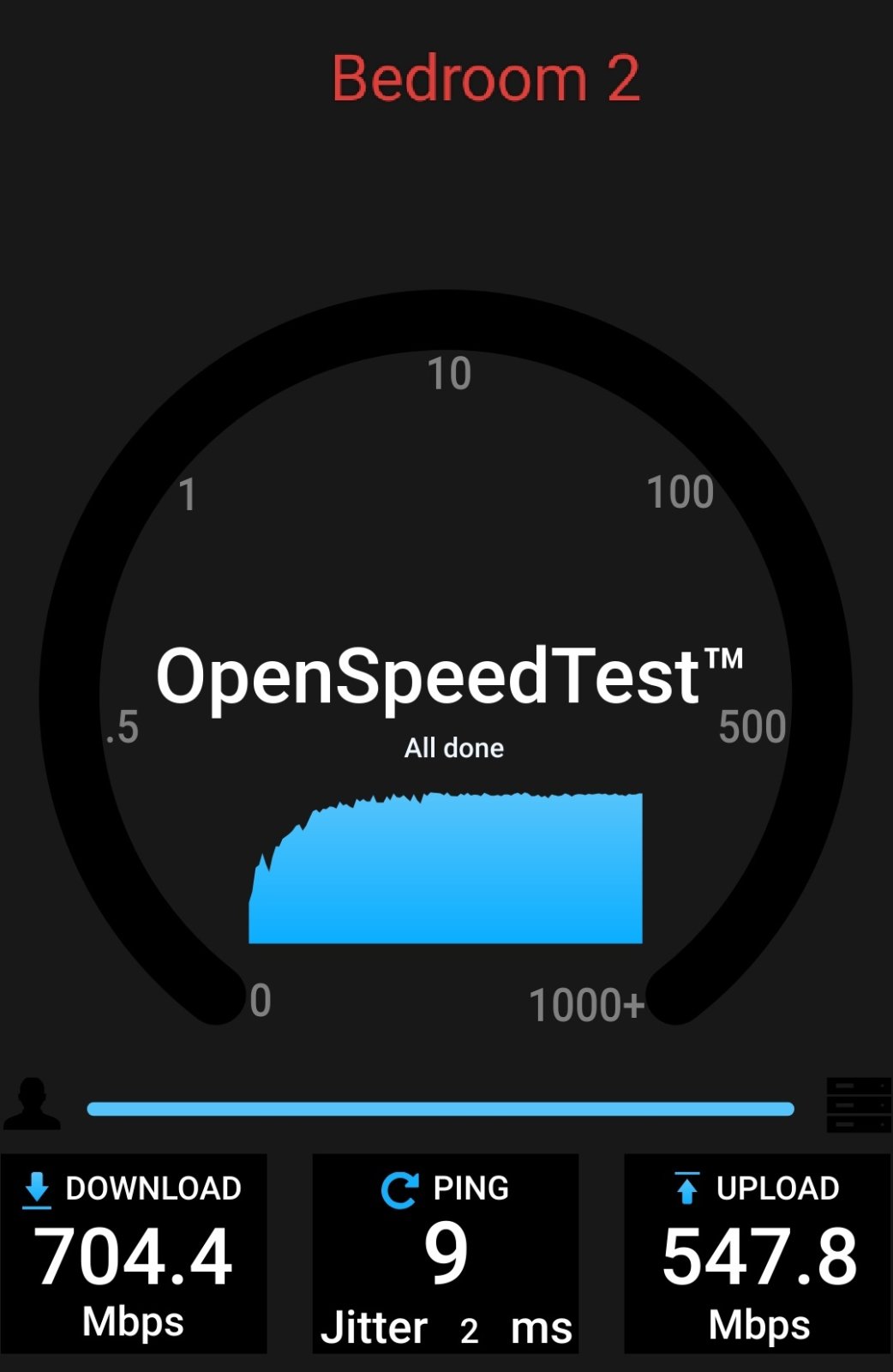

    • When I plugged ethernet cable into LAN port of Satellite, logo went to green. Local speedtest ~550mb/s and ping ~9ms. (Ping similar to other WiFi I already had) Note that the main router needs to be in AP mode and both router and satellite must be plugged into switch with their LAN ports.
    • View attachment 211924View attachment 211923
