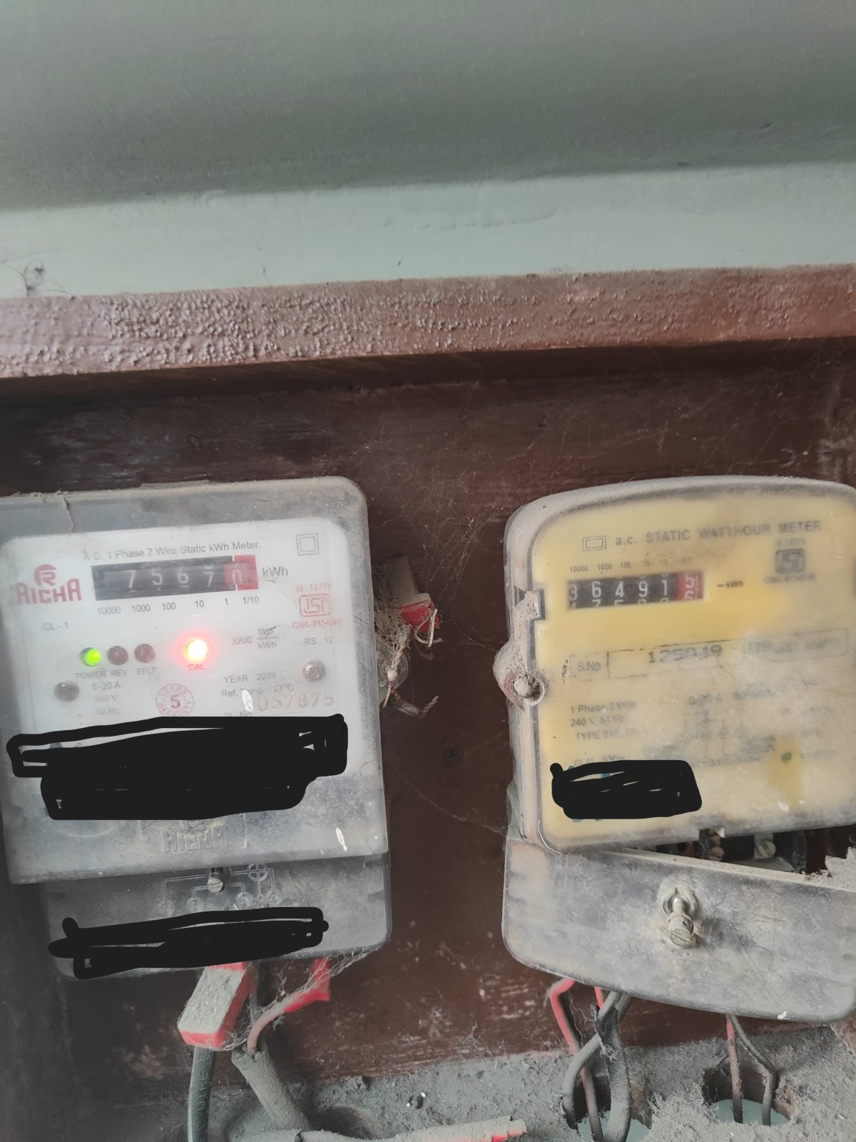

Our Energy meter as per 7th June 2023 :

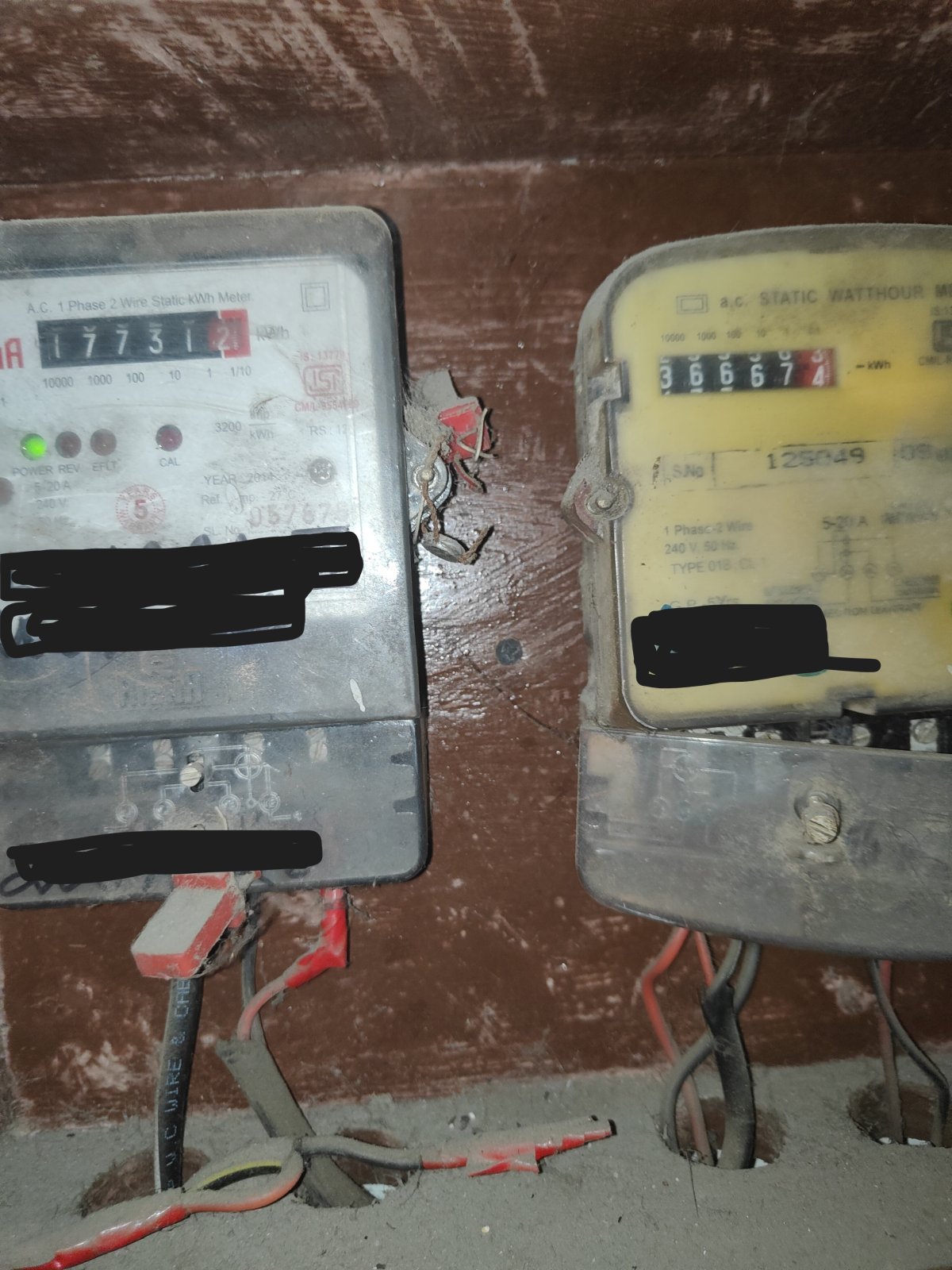

Our Energy meter as per 4th July 2023 :
Left side is our neighbour's energy meter while the right side is ours. I am also a bit confused on how to read the kWh displayed on the meter, am I supposed to read the last line written in red too? If not, then our usage is as follows :
1. Neighbour's 1 month usage : 17731 - 17567 = 164 kWh
2. Our 1 month usage : 36667 - 36491 =176 kWh
The difference in our usage is only 12 kWh yet they are billed around Rs 850 while we are billed around Rs 1700. This seems sus tbh but I am very ignorant about it. Before knowing our actual usage difference, I thought of changing our meter but that doesn't seem to be the issue. If you know how to calculate bill from usage, have tips to lower it or an idea as to why this is happening , please help me out, thanks.

...am I supposed to read the last line written in red too?
Read is the 10th value, so it is 17731.2 units in this pic, can be ignored for calculations.

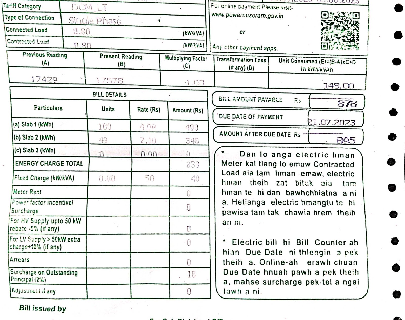

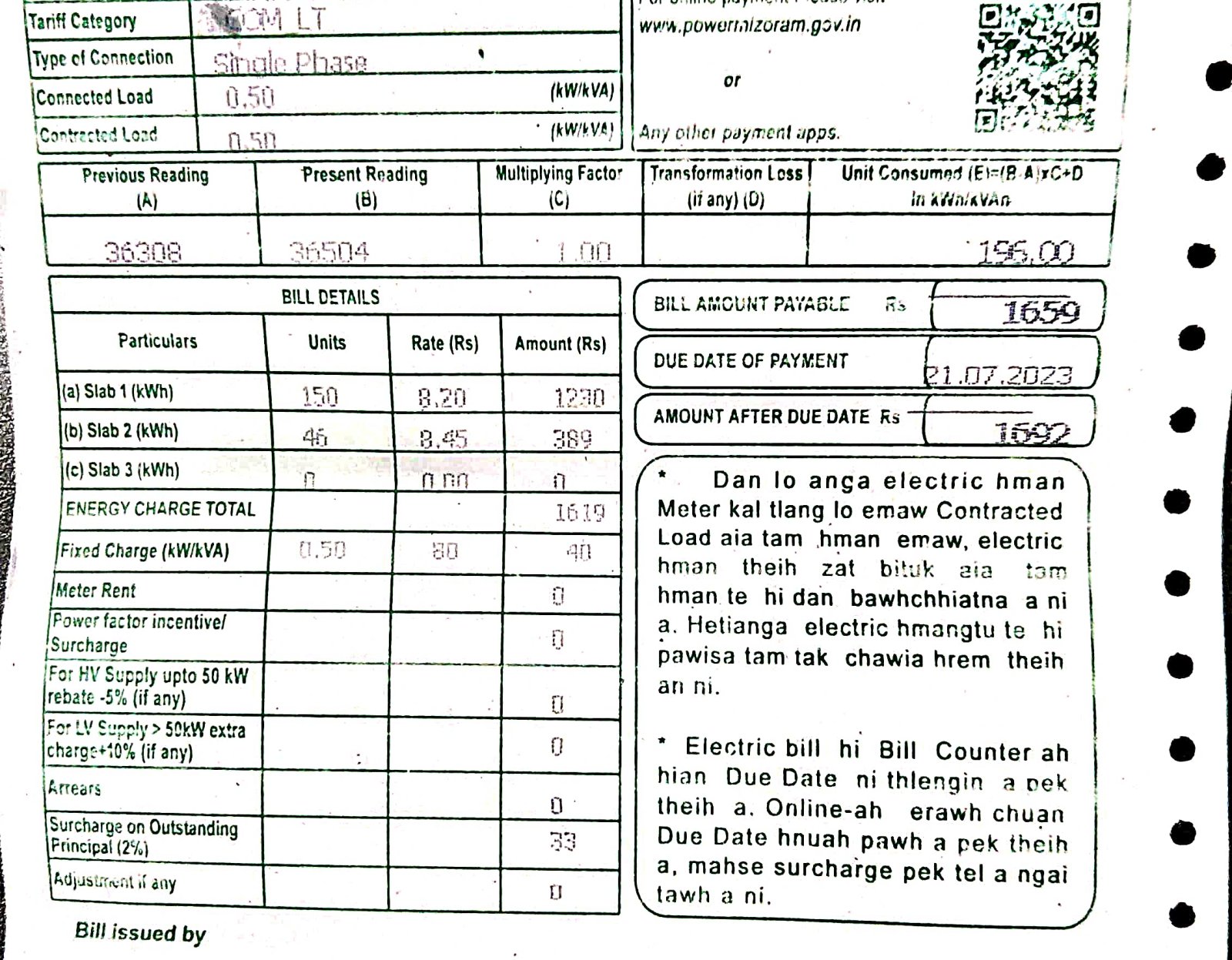

Guys, the physical copy of the bill arrived, please take a look at it for me. The one difference i notice is the tarriff category, while we are on "COM_LT", neighbour is "DOM_LT", no idea what they are though.
Our bill

Neighbour's bill
So they are charging us as if we are using our electricity to do business?
That's what it looks like. IIRC,COM_LT is the term used for Commercial Low Tension category.
Are you sure you're using the electricity only for home purpose or some commercial establishment is part of it?
Com is commercial and dom is domestic.
Your supply is registered under commercial category.
Unless you're conducting some business from your home, this might be a mistake and you should get it corrected.
Thanks guys, this definitely is the reason. I should make a complaint, I looked at our old bills and seems like this have been going since last year. I wonder if reimbursement can be done.
