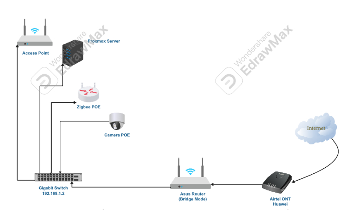

I am currently on Airtel xsterme and this is my setup

This is how I am anle to do it on my Airtel Huawei ONT
