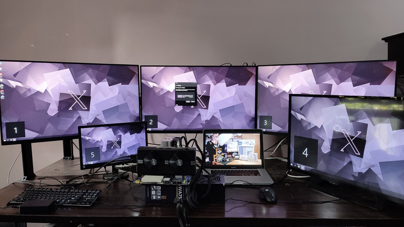

And your current setup has got plenty of screen real estate. Nice setup. Could you please tell how you have connected these 5 screens together and how are you able to monitor your proxmox servers on these monitors, like how do you connect those so many machines with these monitors?

@rsaeon , I noticed that one of your monitors is also glossy which has got a lot more REFLECTION, compared with your other monitors. It is named Monitor-4, where I have highlighted the reflection.
I want to avoid this type of reflection at all cost, because I will be looking at these monitors for long duration continuously.
Your all other monitors look good to me. Thanks for sharing this.
This was a test setup to show potential buyers that all five of the outputs of a graphics card were working. The card had some damage so there was a doubt. @tech.monk generously offered to buy the card at my asking price which helped me out of an emi hole (nevermind that I'm in another emi hole right now ha).
At the time, only the 3x 32" monitors were permanently connected, I brought in the other monitors for testing from other systems. The 4th monitor is actually a TV, it's now setup somewhere else for my mother to watch KBC.
My main desktop is a M1 Mac mini, it has two display outputs, so I use a Dell D3100 display dock to drive the third 32" as well as another smaller monitor, for a total of 4 currently. The display dock uses DisplayLink to drive a monitor on the USB bus and this model can drive up to three monitors. Because bandwidth over USB is finite, you'll need to consult the manual for these kind docks to see what combination of resolutions is possible.
As best as I can remember, this D3100 is the last or only model by Dell that supports three displays from a type A port. Everything else supports just two displays per type A USB 3.0 port.
