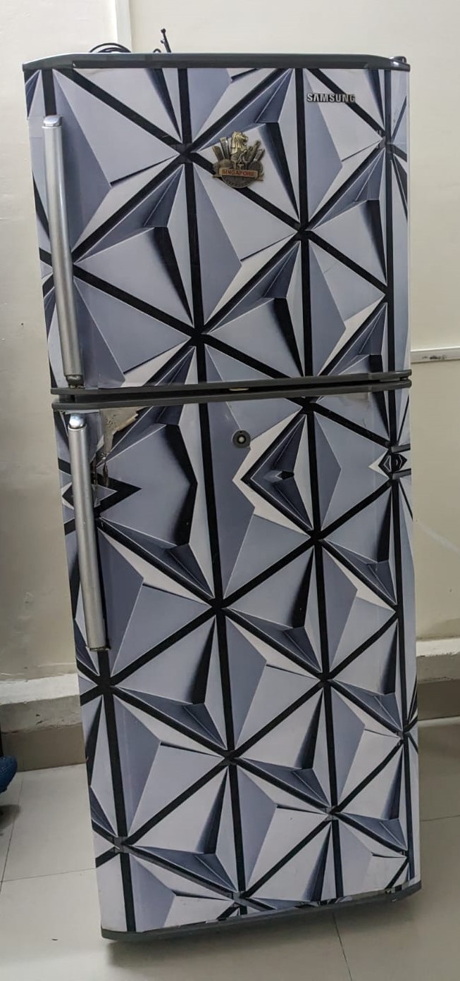

Dirt cheap if you do it yourself . Adequately available on Amazon and FK . I have same refrigerator and had installed this wrap/skin 4/5 years back
Its started to now peel off but worth the price

Oh that's great, can you please show some pics of how you wrapped it. Even if it's not as good looking now.
Post a photo. Let's see your handy work :)
Dont laugh , skin is peeling off where uses max . I think same model as OP
Oh wow, that's pretty cool. Thought you'd have gone with some solid colour. More interesting choice here.
As a proof of concept this is definitely doable. You should have kept some spare for touch up fixes later. You'll never find this design now.
It was spare/extra , lost it long back

Any tips for wrapping it? How did you cut it around the handles?
