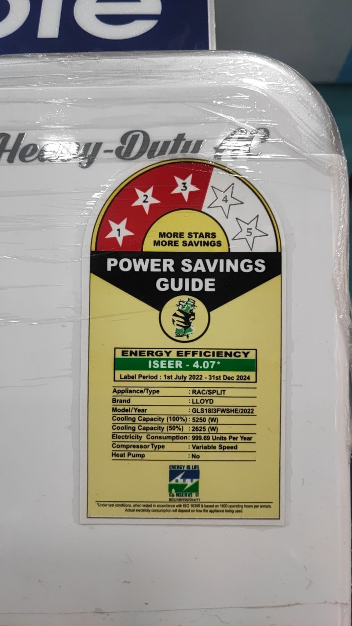

I am posting a picture of a Lable, I need a help to identify that this Ac's star rating belongs to which year? also Please help Is this AC good? This is a label of Lloyd AC.

higher iSEER lower energy consumption
after expiry of label period 3 star will be 2 star equipment
cooling capacity is measurement of how much cooling it will provide. 5250w is true 1.5 ton lesser w will mean lesser cooling. Lg giving 4600w cooling in 1.5 ton which is not truely 1.5 so will cool less
energy consumption 999unit shows electricity unit consumed by this ac when continuously run for 1600 hours
compressor variable means it's an inverter ac
