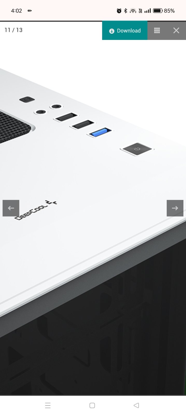

I have a 5-yr-old Deepcool MATREXX 55 V3 ADD-RGB WH 3F and the power button has started giving me issues. It gets switched on sometimes but never at one go. Yesterday, it didn't get switched on the whole day. Today, it took a good 10 minutes before it got switched on. Once it is on and running, the PC functions properly and I have not faced any issues. However, I think the button might be the issue here. So, is it possible to repair or replace the button and wiring (without a lot of pain) or is it time to get a new cabinet?

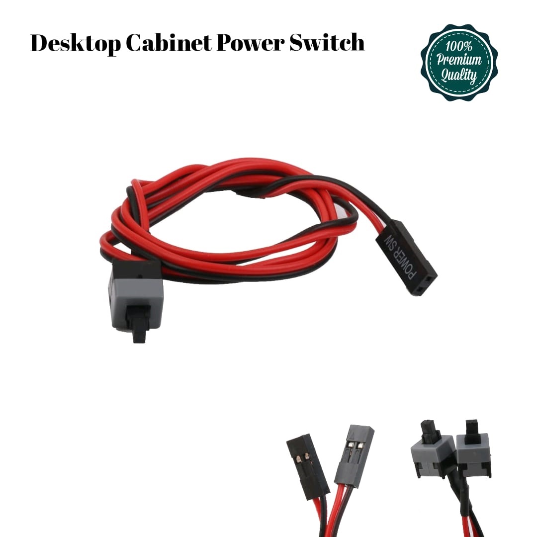

The thing is pretty simple. Getting a full set will make it easy for you to simply disconnect the headers of the power switch on your motherboard and put the headers of the replacement, and you are ready to go. It is pretty simple. I am an idiot and I have done it several times. This will be the least amount of pain since you will not have to dislodge anything in the cabinet frame. You just need to remove the relevant pins and replace them with this, and your job is done.

700rs for 50 grams of plastic and 3 wires seem a lot to me but it's a niche item so kinda understandable.

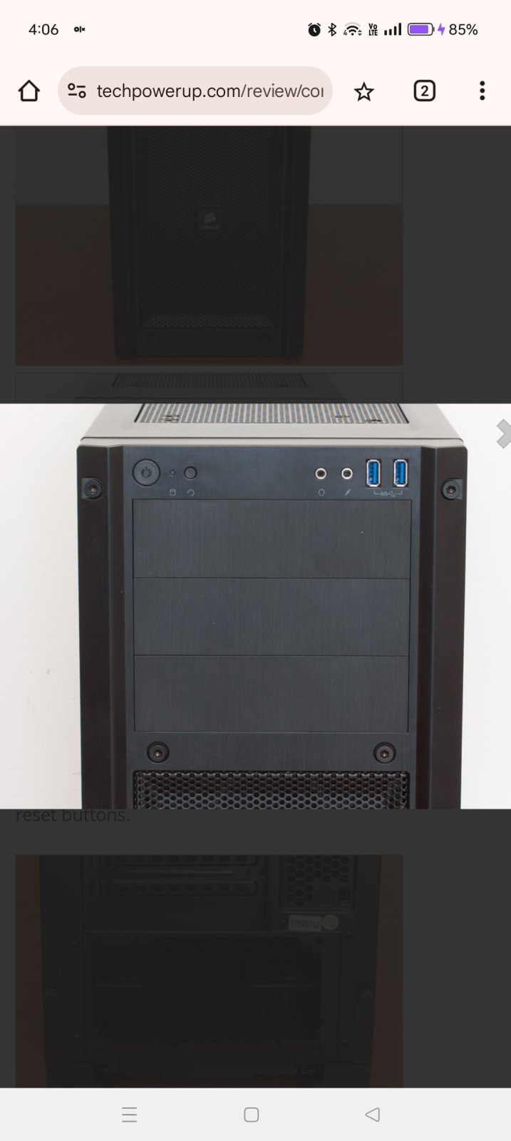

Since the cabinet is premium in its heyday it's always better to get the start and reset buttons replaced and use it than using some alternatives.
Once when my Corsair 300R cabinet start button went kaput after its warranty period I asked for a replacement and Kaizen Infoserve sent me free replacement outside the warranty period but asked me for shipping charges which was ₹350 and I got a new start button.
Total panel will be underneath and they usually give the panel along with front panel cables if attached or just the panel if the cables aren't attached to it.
For Corsair 300R they gave me the panel only.
My Corsair 300R front panel underneath.
