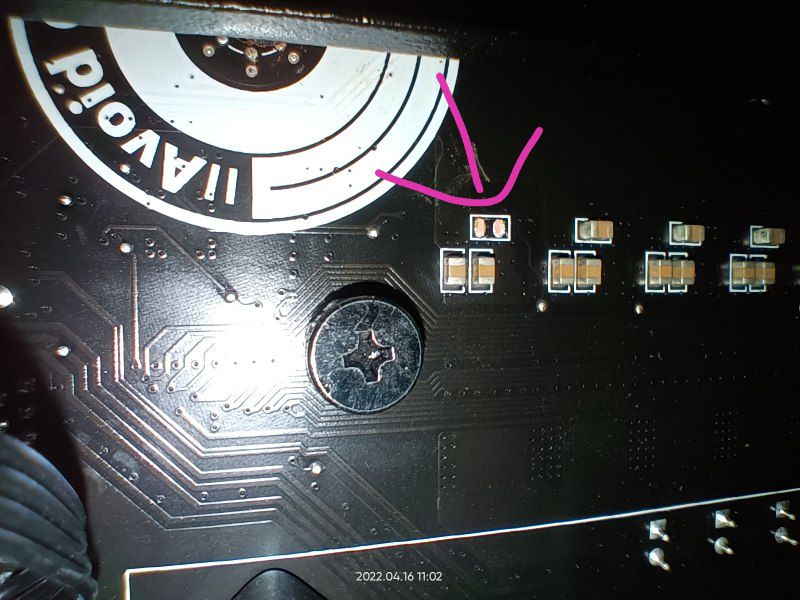

CPU/Mobo Just built my first PC but it doesn't boot. The red CPU light and orange DRAM light on the motherboard are flashing alternatively :( What do I do?

Guys thanks for all your support. I unplugged everything and put it back and found out what the issue was.
I got it to boot. But the first 2 RAM slots are faulty.
The RAM modules themselves are fine and I'm able to boot it if I connect the RAM to the last 2 slots.
Upon closer inspection of the back of the mobo, I found this
It appears that a piece (PCI component?) is missing.
At last I figured out what the issue is and I'm so relieved that it isn't the CPU.
What do I do now? Is it possible to get this fixed via RMA?

I went to the retailer with it. I don't know how this happened, but when he opened the motherboard it had one pin slightly bent in the CPU and he said they can't do anything about pin damage and directed me to MSI service center.
Instead of going to the service center right away to be told the same, I went home and looked up on Youtube to find how to fix the bent pins and went ahead and straightened it out. It must have happened when I plugged everything out and was trying to put the plastic cap back on the CPU slot. Anyway, it was such a minor bend. I was able to fix it right away.
After fixing the pin I went to the service center, gave it to them. They inspected the CPU pins with a magnifying glass and saw that it was all good and took it in. I've got an RMA number and it's going to Delhi and the ETA for resolution is 10 to 15 days.
i hope you have checked page 19 of motherboard manual and connected rams in correct slots ,its not necessary its a missing component it could be by design not placed its a very clean pcb ,check some overclockers /tweaktown or some other hardware forum (they generally take a very high resolution photographs of mobos if they have reviewed. from those photographs compare the component in question) and check whether you are the chosen one or all the motherboard has the missing SMD.

They take a the Mobo alone but if RMA is fresh piece you should be getting a new sealed piece.
Got my mobo back from Kaizen. They said 2 weeks but it took 3 weeks, but anyway they sent me back my fixed mobo. It wasn't a new unit. Just the same mobo fixed up. And the RAM and everything else are working great.
So I guess MSI warranty does work after all. In case anyone was wondering.
Strangely though, that missing piece is still missing. So maybe it wasn't an important component to begin with, because everything is working as it should. At least as far as what I've been able to test. So it's all good I guess.

Maybe there was nothing missing from the starting itself. Many times motherboard manufacturers use same layout for several motherboard with some minor stuffs here and there. It's really difficult to say that something is missing without actually referring another motherboard (same model).
