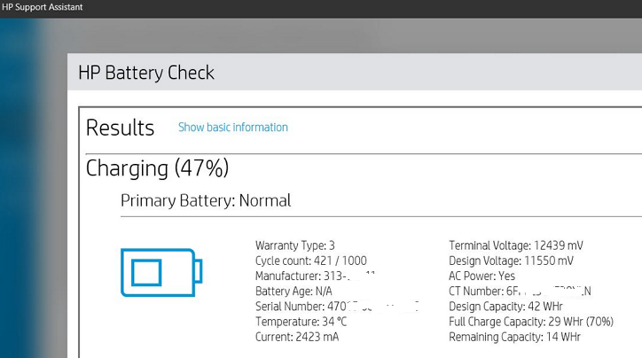

Run HP Support Assistant and run battery check. You should find the serial number and it will mention issues with the battery, if any.

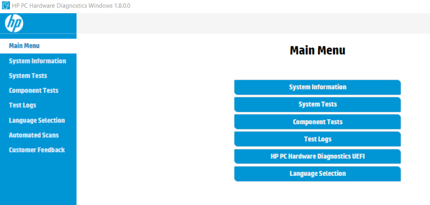

I use these Hp tools for my HP laptop...
I use these two official HP tools for my HP laptop.

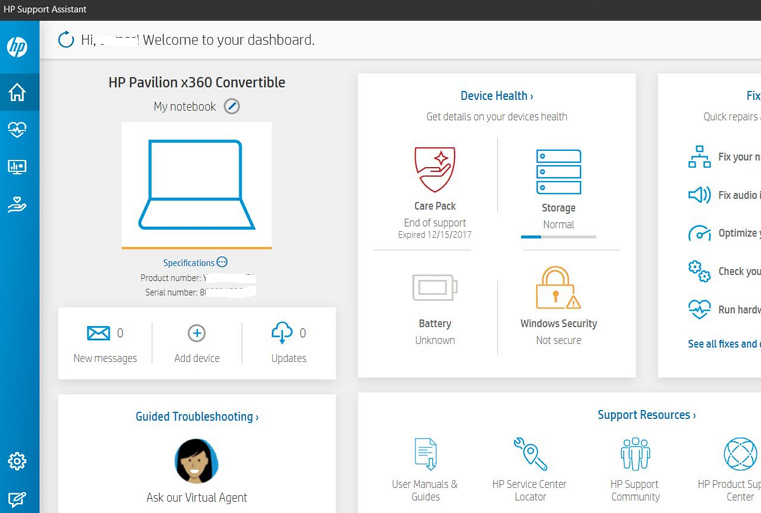

Will get back regarding the support assistant screenshot.

Hp support assistant screenshots
What is ct number? Check cycle count, that means that something's wrong?
It means to leave it plugged for 2.5 hours after its is fully charged? Will it not overheat or cause damage to the internal parts if kept plugged in for so long?
Calibration tutorials said to calibrate like this
But support assistant is mentioning a completely different method. Are calibration methods different with every oem?
No, it won't overheat since when the battery is at 100%, very small charge goes to fully charge it to 100%(actual) unlike regular charge where your battery charges and it build up heat.
Do the calibration process once. I had done the same and it helped me determine if the battery was faulty or not. Turned out, it was faulty.

Why is hp saying to keep it plugged for so much time?
When the battery indicator says 100%, it never is 100% initially. If you understand battery chemistry, charging upto 50% will be at max supported capacity, 50-80% will be at reduced speeds, 80-100% will be like trickle. That is why when companies claim 0-50% in 30 minutes, it can only charge fast when its void. As electrons start filling in, there's less charge to move and hence speed slows down. Also, it makes sense to slow down charging after 50% because the heat during fast charging will damage the battery.
So due to slow charging speeds, HP wants to ensure that your battery has been topped up to exact 100%. It's the same as when your phone switches off on reaching 0%. If you power it on, there will still be some juice left which is needed for internal functioning. Having a completely dead battery is bad, except for calibration coz you are doing it only once.
What is the name of this software? How is this different than hp support assistant?
HP PC hardware diagnostic tools. Runs battery tests and suggests ways to calibrate the battery in the manner deemed fit for HP batteries.
