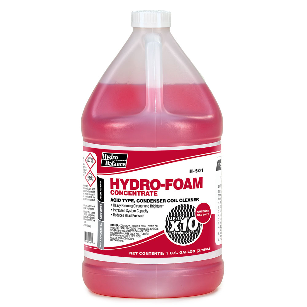

Ac fins and pipes collects dust and moisture from room over time.it is hard to remove.Thats why we see blue coating fins,gold coating fins they for same purpose.these fins doesn't let water droplets on fins so only dirt deposits on them which is easy to clean with water.Water and dirt deposit on fins is really hard to clean.If a mechanic cleans ac with water it will not look clean to customer because some dirt marks remains on fins.machanic out frustration will put double quantity of acid cleaner on fins now.AC cleaner is mixture of acid and some foam making chemicals with 10% hcl in it. acid will cuts dirt and foam formed will push that dirt out of narrow spaced fins .Condensor cleaned this way looks like new and shiny and increase in cooling as brand new.Biggest drawback is you will need 200 letre water to get rid of acid from fins and pipes and still you will not be able to get it completely off the fins it will remain there and keep damaging fins over time.even if you have cleaned your fins with acid based cleaner only once it will damage fins same way as it was cleaned 10 times with acid.you don't have options sometimes if you have not cleaned condensers for years then condensers will be clogged so heavily that they can't be cleaned with water and brush you will have to use cleaners to remove heavy dirt.Moisture and dust makes a solid type of blockage between fins.If you got some sort of coating on fins they will get cleaned easily with water only a few durt marks will remain on fins.Here is where customer becomes dumb if a machanic has faithfully cleaned fins with water and brush don't ask him to clean fins like mirror shiny you are not going to shave you beards by looking at fins if air is flowing freely trough fins they are well cleaned.Now to remove those marks machanic will use acid based cleaners now.This is main reason mechanics uses acid based cleaners because customer is never satisfied with his work and wants every mark to be gone from fins.With acid based cleaner it takes 15,20 minutes to get them cleaned and with water and brush it takes 3,4 hours.so machanic can clean 10,12 ac in same time he is not going to waste 2,3 hours on single ac.front condenser in cars is always cleaned with acid it gets cleaned with water every time you gives your car for washing.Dust stuck between fins is so hard it can be removed with cleaner only.

If ac is cleaned with acid then neutralize acid with base like calcium carbonate.i learned this on site where people repairs antique radios.they removes cover from old copper wire get rids of oxidation on copper by acid and neutralizes acid with CC water and soldiers wire.They have small test tubes filled with acid and neutralizing agent.If you try to clean condensers with anything that have sodium hydroxide(caustic soda) it will react violently with aluminum fins.Try to put a silver foil in caustic sauda and see what happens.Thats why soap,washing powders are not recommended for cleaning condensers.

Sulphuric acid will not react with aluminium but it will react with copper pipes.HCL is used in all cleaners as it doesn't reacts with copper.This chemical cleaning was for centralized ac very big units which were hard to clean and now they have bought to smaller home units to do the job quickly but it is harmful for small units.there is no neutral ph cleaner if you neutralize acid it will not clean.Even bear cag cleaners contains nitric acid.Key here is to neutralize acid which on surface and it will keep reacting with metal.calicium carbonate mixed in water will neutralize that acid and it will stop reacting with metal and you are good to go.If someone cleans a firearm barrel with acid it is considered unfit for firing and then barrel is backed in oven or heated at certain degrees to relieve steel from acid there is special term for it but it got out of my mind now.There are some special chemical cleaners but they are patented by different companies.look google online patents for them.Look at msds of chemicals used by very well known companies for further knowledge.
ok but what surprised me acid was being used. See, to clean dirt normally requires a base not an acid. Both will do the job but it seems the industry has found acids to do the job better in this use case.
Citric acid has a ph of 2 that is pretty acidic as well. This is used to remove hard water scale. You would not need to neutralise it with a base after. Just a good wash would remove it.
Not as caustic as sulpuric or HCL though and likely slower acting. Gentler perhaps.

Acid doesn't goes well with anything.In order to stop acid attacking metals you have to neutralize it with a base.Again strong base like sodium hydroxide will also eat away metals.There are lots of patents given in recent years for products with mineral acids as main ingredients in many categories. Last year Nobel award was also given to a scientist who had worked on sulphuric acid.there was also talk of nasal spray for corona based on acid.They are very dangerous in lower consontrations as low as 10% and people should stay away from them a drop in eye and it will blind you,if it falls on cloths it will cut a hole.Acids have got bad name here because of it's use in crime against women and sulphuric acid is used in all cases and same acid is used most widely. all explosives and gun powders are made from acids.from pistol bullet to missile.It was invented accidentally when a scientist wiped spilled sulphuric acid and nitric acid with same cotton piece and as soon water evaporated cotton burned giving a bright flash.that incident gave the idea to make nitro cellulose a smokeless gun powder.later other acid based propllents were added to make it double proplent,triple proplent according to needs.Dynamite is combination of 2 acids and stone powder or saw dust to keep it stable.There are lots of research going on in this field.India or USA damn Chinese makes everything.
This is used widely in India and other countries as ac chemical cleaner.
