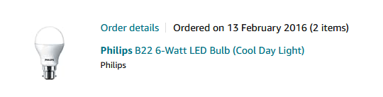

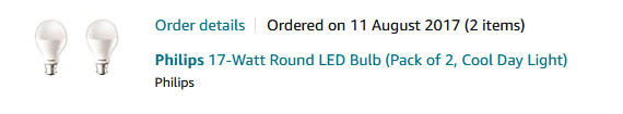

Still working
One of them failed in 3 months and was replaced. Both are still working.
All 6 are still working, with no apparent dimming. And are used on a daily basis.
