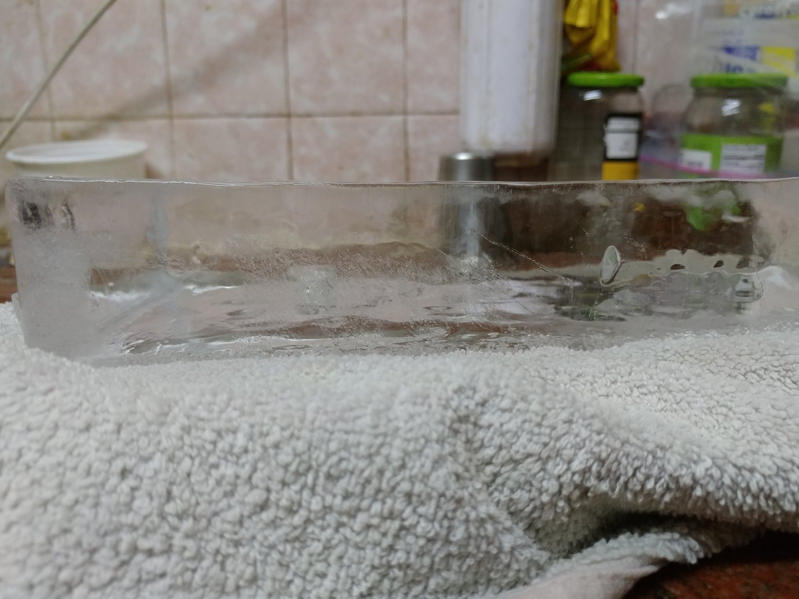

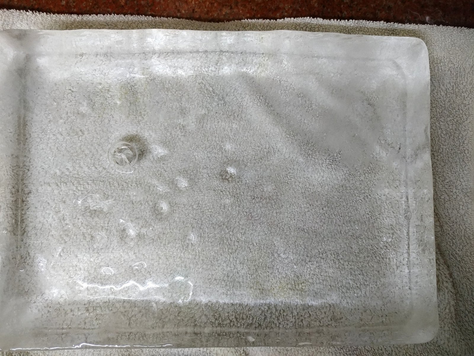

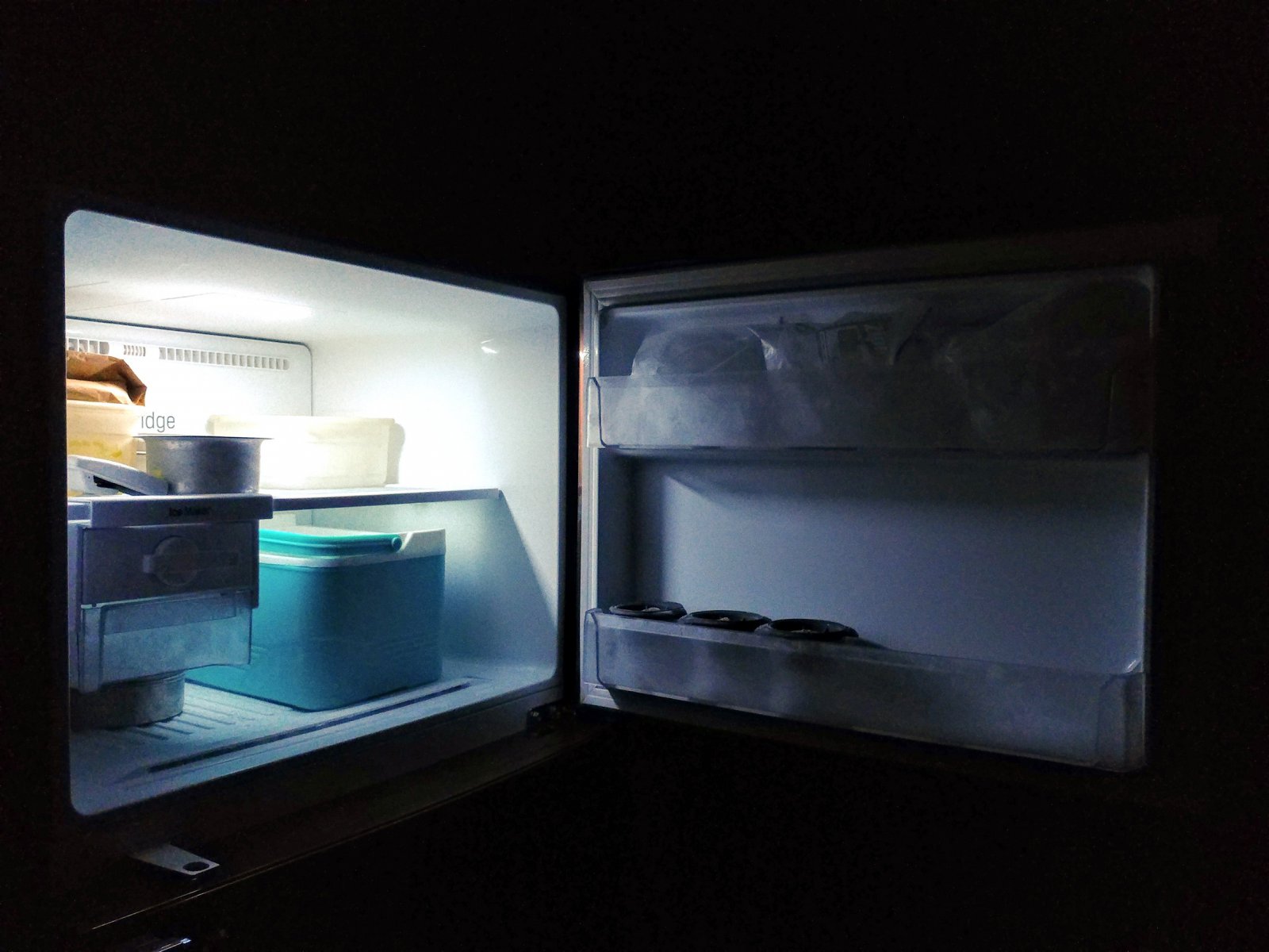

How about going in the opposite direction. Instead of boiling, try freezing. Make ice in the freezer. Then defrost it in some container and you have pure water.
Now, the trick is it has to be clear ice not normal ice. Ice you can see through, ice as clear as glass. My initial tests are promising. Took a clear ice cube and let it melt in a glass. Aquaguard water TDS level came down from 140 to 1. Should have been zero but i suppose some contamination occurred. I am still amazed at the result. Better than Pepsi's 5 stage RO process :)
Slab is about 2 inches thick and will make about 2 litres. Simple way to get de-mineralised water.
The theory is the dissolved salts and small particles are pushed down into the water at the bottom. If the minerals were trapped in the ice you'd see the ice as imperfect. This is because the water would crystallize in odd shapes and would appear as white or just opaque when frozen together. The crystal structures start to build around the mineral and when they meet they can't form perfectly, leaving visible imperfections. However, pure ice frozen perfectly is crystal clear.
It's a slow process, but for individual use not a problem. Would take 48h in the freezer to get enough clear ice to make 3 to 4 litres of pure water. Depends on the size of cooler and how big your freezer is.
View attachment 81360View attachment 81362View attachment 81361

Not melting all of it. Only the clear ice portion. The rest is discarded. Unless the ice is clear it won't work.
I don't let the whole lot freeze. Somewhere between 24-48h i remove it so less than half has not completely frozen

You don't freeze all of it. Not like this
Instead it should be like this. Notice the top part, it has water in it. That's where the impurities are.
You cut off that part and then it looks like this.
That's the slab i posted above. Now i took a small sample and melted it. TDS was 1
It remains to be seen whether the whole clear ice slab melted will be the same but i expect TDS to be very low.
Bear in mind you cannot simply do this in any container. It needs to be insulated on the sides and a cooler with the top open is easiest way to achieve it. Read the link in my previous post.

Got it guys! i didn't realize you cut off some parts..
Just the bottom, and ice to be made by directional freezing otherwise you won't get clear ice at all.
I got the cooler to make clear ice for drinks then decided to test the water.
