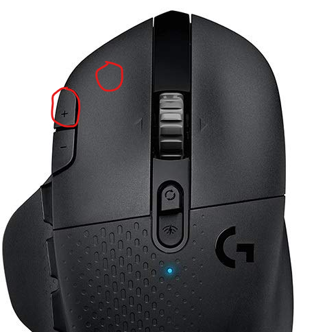

My Logitech G604 has developed double clicking in the left click, intermittently on right click and on the plus button (See reference picture below)

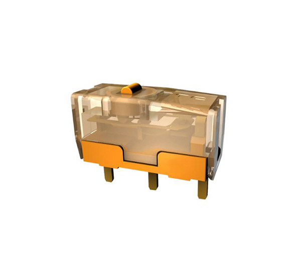

Are kailh black good option - https://www.genesispc.in/product/kailh-gm-micro-switch/ or should I opt for these - https://www.sunrom.com/p/replacement-switch-for-mouse
Also, where can I buy skates for my G604, in case the feet removal gets botched?
Are all of the above listed switches compatible with any Logitech mouse? Is it just a difference of click rating and operating force?
I recommend the kailh black as i have replaced my logitech switches with the same and the click like omrons. I would not recommend the sunrom.com ones as they have no rated life and can go bad quick, or they can have mushy click like the side buttons of mouse. However i havent used them so its your choice.
