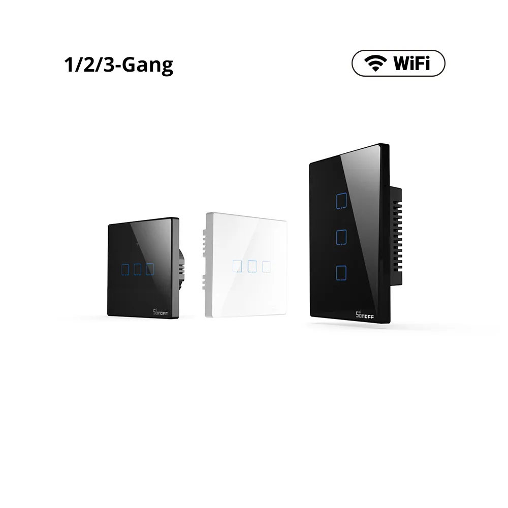

How about just buying simple smart switches? Won't that be much simpler. I use these because it allows them to be installed as normal switches which can also be used manually.

Oh, so you are doing it as a sort of learning project. I wanted to do the same once, but the parts cost was coming to a lot more than what I could do with these switches and they were such an elegant looking solution compared to what something I would build would look like, so I went with them. They have a limit of 2A per channel, but I use them as a control switch and then use a relay/contactor in my water room to control my pump as well. So I am able to control 3 devices per switch which was extremely VFM for the price.
You could even do a learning project on the sonoff switches..
They come with a USB TTL header - so you can flash alternate firmware like espeasy or tasmota on it
Only reason for OP to not use sonoff and something like a esp8266 (or arduino) would be because he has multiple relays to control
1 esp8266 for i guess 300/- will handle 9 vs single (or max 3) channel for each sonoff
