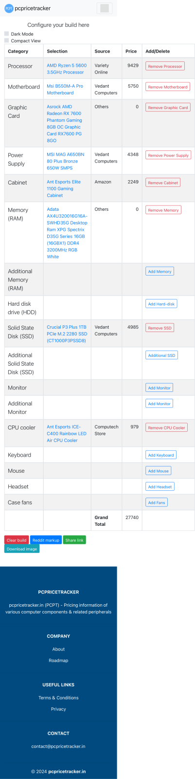

allow me to clear your misunderstanding. as stated above "for reference", no one is advising the OP to get exactly what is listed. everyone else who contributed in this thread also knows that the chance that the OP will get the specifically advised parts is a variable.
focusing on the specifics you've quoted, i advised on getting an r5 5500 as it costs less but performs basically the same across the board which will save money for other parts. again, as stated "for reference", i went to mdcomputers site and put together a list of parts which would be close to the stated budget on a whim so the OP could get an idea on building a PC around the r5 5500.
as for "the trend", i don't know either. as far as the board is concerned, am4 is known to be a platform which supported upgradability as amd is releasing new cpus for it, even now a new range of am4 cpus are bound for release. a mid range kinda fits in the picture as i was guessing the OP would want to upgrade the cpu in the future since the upgrade path for a 12th gen intel is kinda limited compared to maybe a 5700x3d or a 5800x3d in regards to gaming which the OP has mentioned in his post. yes, you're right that even entry level boards can work with most supported cpus. let's be real, this is suppose to be the OP's first build and wants new parts, you have seen the aesthetics of a mid range and entry level boards, right? with the more populated i/o ports along with looks and appeal work wonders in buying parts for most people, right? i'm not hoping the OP is the sweatiest kind of pc builder who opts for saving money alone, so , making an educated guess would be an affordable mid ranger within the budget. which could even be cut down to a microatx stated above to save even more.

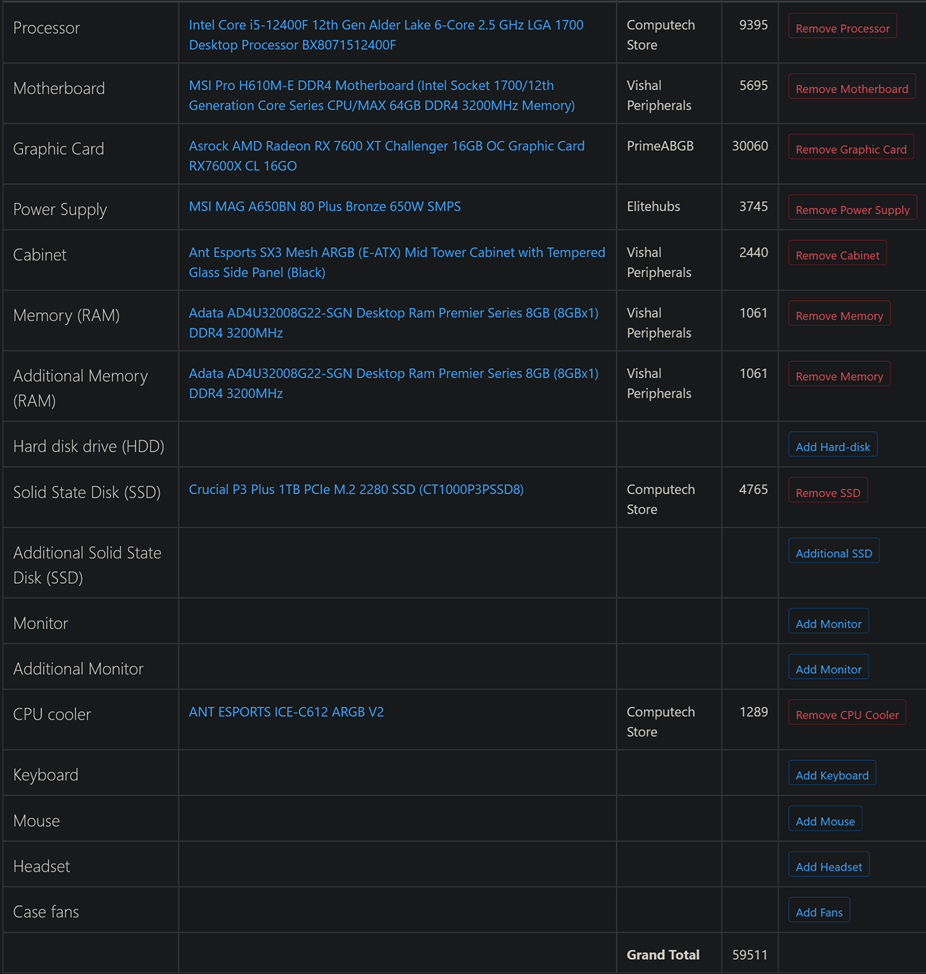

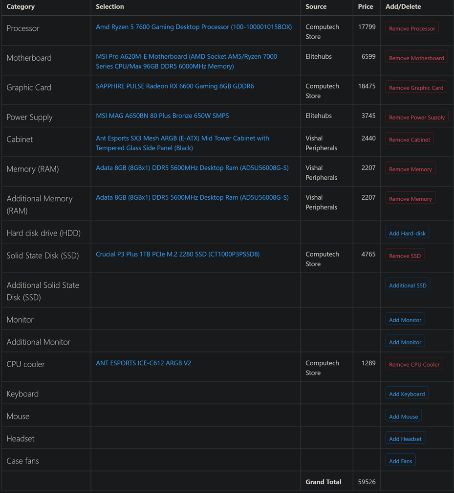

Below is what I could come up with but I really feel like Ryzen 7600 with RX 6600 is bad combo. GPU is simply too weak to fully utilize the processor. Ryzen 8400f is also not that good compared to 12400f which is cheaper which in turn means you can upgrade the GPU further.
I have posted both builds below.
