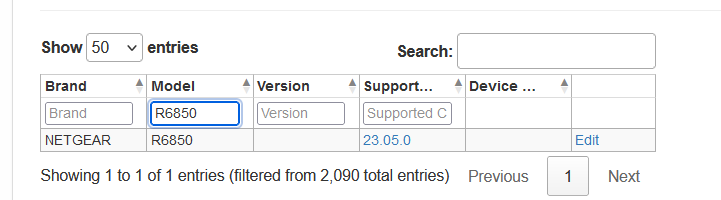

FreshTomato is not available for the Netgear R6850.

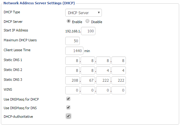

Do share some screenshots of the OS. It could help compare with OpenWrt.

That Netgear R6850 is interesting. I missed it while I was looking to buy an openwrt-compatible router yesterday.
I ended up buying this TP-LINK AX23 instead for 4.3k. It also supports the latest version of openwrt and has a slightly different revision of the same mediatek soc that the netgear has.
Now I'm wondering if I should cancel it and get the netgear instead. Because for Rs 200 extra, you get:
  • 128 mb of nand flash vs only 16 on the tp-link
  • a usb 2 port for ftp and storage
On the other hand, the AX23 is WIFI 6 and 4x4 mu-mimo. Which should make it a no-brainer but 6 only results in marginal/situational perfomance improvements over 5 according to this. And the vast majority of devices only support 2x2 mimo anyway, with some benefits in range and signal quality from the 4x4 configuration. Hmm.
