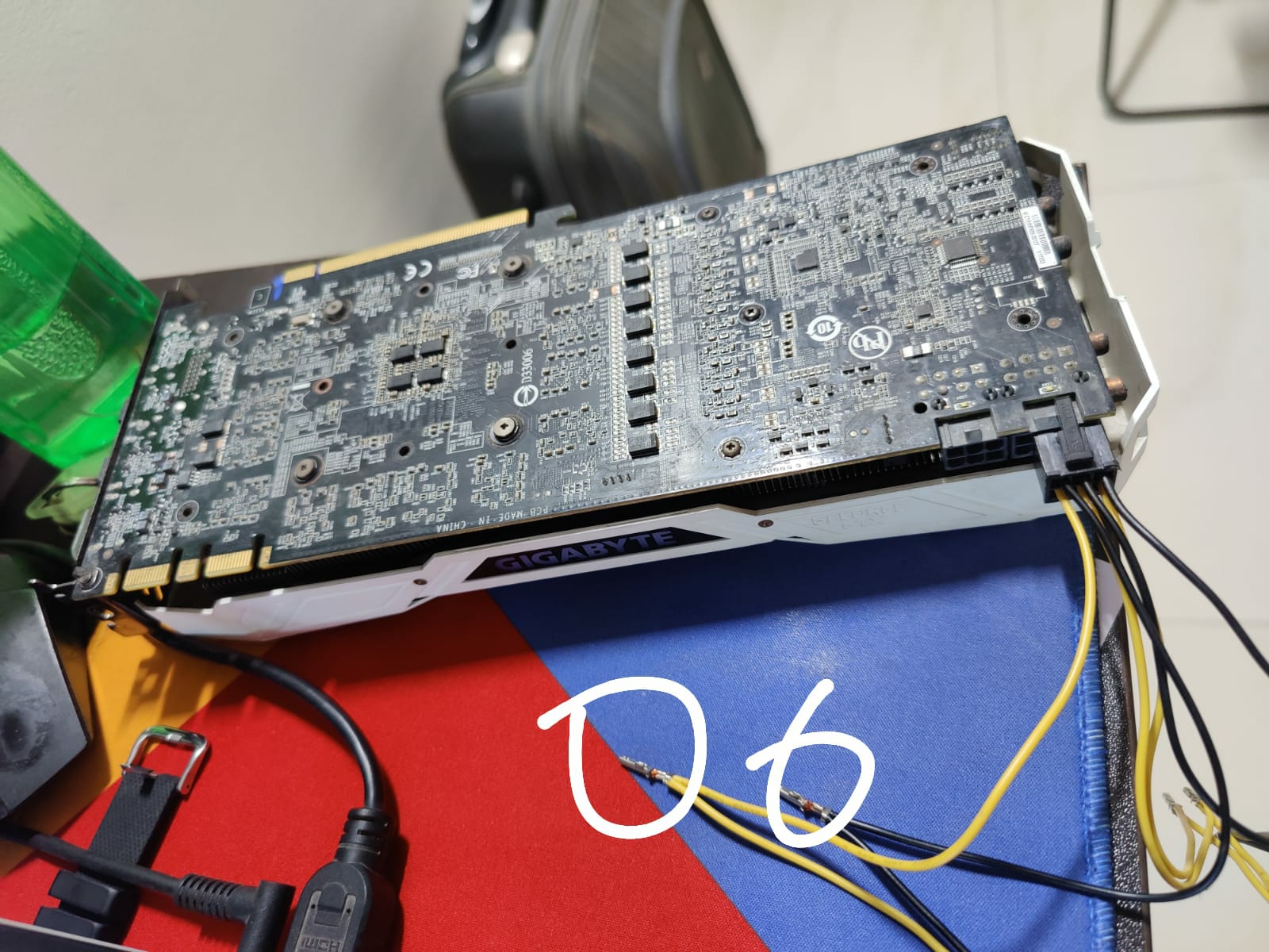

PC does not boot with the 1080Ti even with another known good PSU. There are 0 signs of power. Still no fans, debug LEDs or anything. Just the RGB on the RAM that auto turns itself on without any input on from me.
Using a spare 6pin PCIE power cable with open wires, I checked the +12v and ground lead on the card with a multimeter, set to continuity mode, and it shows 100% continuity (it beeped), indicating there is a short. Seems obvious that the yellow and black should not show 100% continuity, right? Adding @rsaeon who is also an expert here on PSUs and can help confirm the previous statement.

No solution found in my case. But there are a few reasons why the short happens, some are fixable some are not. I sold the dead GPU on OLX.
